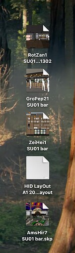

Thumbnail previews are no longer working in Mac
With the macOS 15.3.2 update, SU 25 thumbnail previews are no longer working in Finder.
Any ideas???
