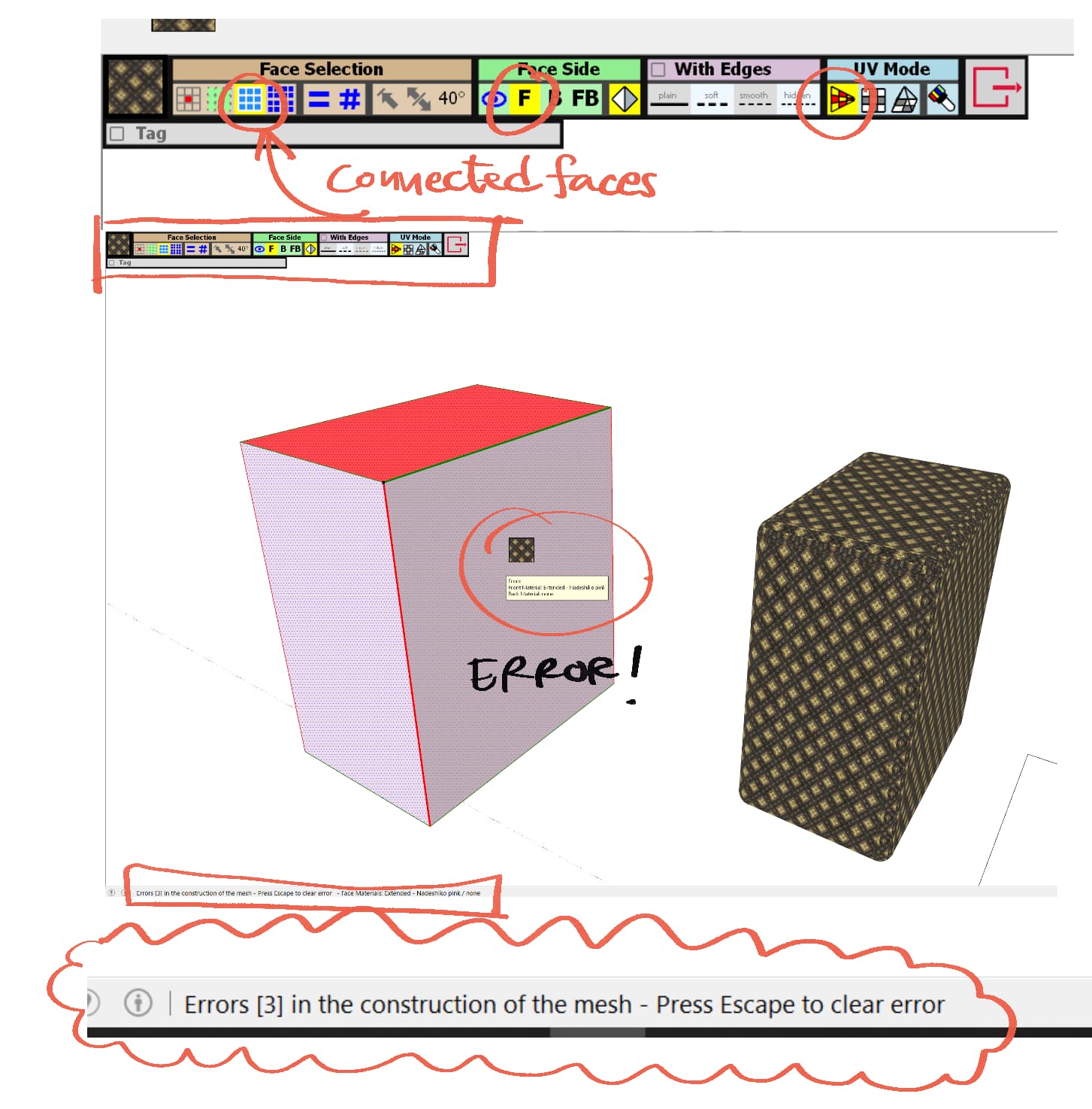

I always use ThruPaint 1 for quick assign material to component.
I just update V2 and get this error messsage when paint material to connected faces.
What I should do to fix this error ? Thank you.
ThruPaint V2 Error_
I think the problem is that your UV Mode is ‘Quad Mesh’, whereas a cube is not a quad Mesh (hence the red face warning)…
I suggest you witch to Natural mode.
Oh Thank you very much. I will test and feedback.
Thank you. Problem is solved :slight_smile:
