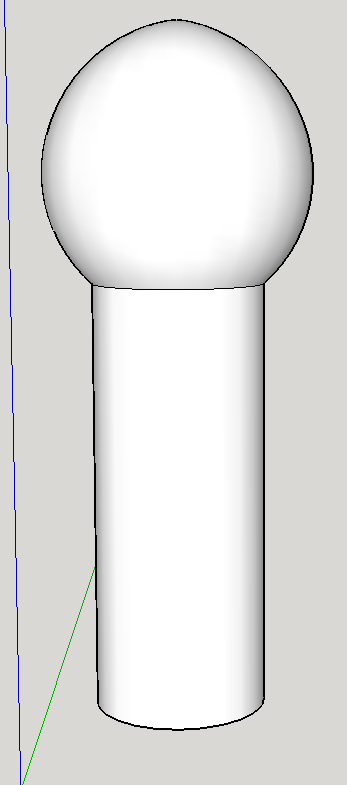

It’s a small spindle that was scaled up and down, so it’s just lucky the size is correct?
Ahhhh… So it could be a little off its original scale. Why scaling up and down?
It’s small 1 1/2" high, I scaled it up to close the hole in the top center, then back down, someone named @DaveR taught me that.:grinning:
The picture looked fine in the preview?

As you said yes, your egg was scaled and saved to look like you had it on screen (probably when you created the component it was different and it was stored like that by Sketchup). If you’d say no, your egg would look different from screen (and just like when you created the component).
