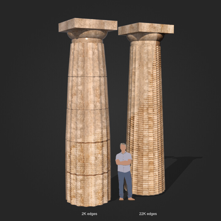

Columns
2K edges (2.000) vs. 22K edges (22.000 - yours)
