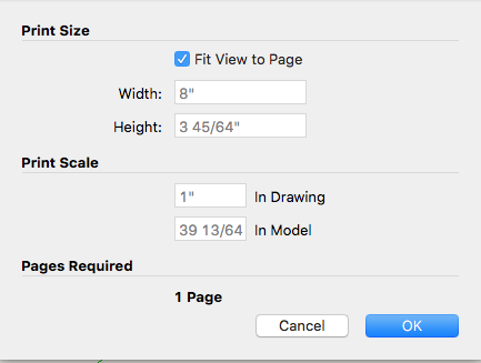

1 - printing templates in windows (parallel projection and a standard top view) I had a screen with numerous settings that I don’t see in MAC. The 3 screens I have are very limited (page setup, document setup, print). There is no print preview but when I hit print I see the preview - so I guess that is it? In the document setup screen I have the ability to set the scale but that’s it. I suppose I don’t need all the other settings that windows presented when I did a preview and then print, which always showed the same settings.

What template are you talking about. Are you just referring to printing to scale? The set up in SketchUp is the same but when you get to the Print screen, untick Fit View to Page and set the print scale as needed. Right now it looks like 1 in equals 1 meter.
