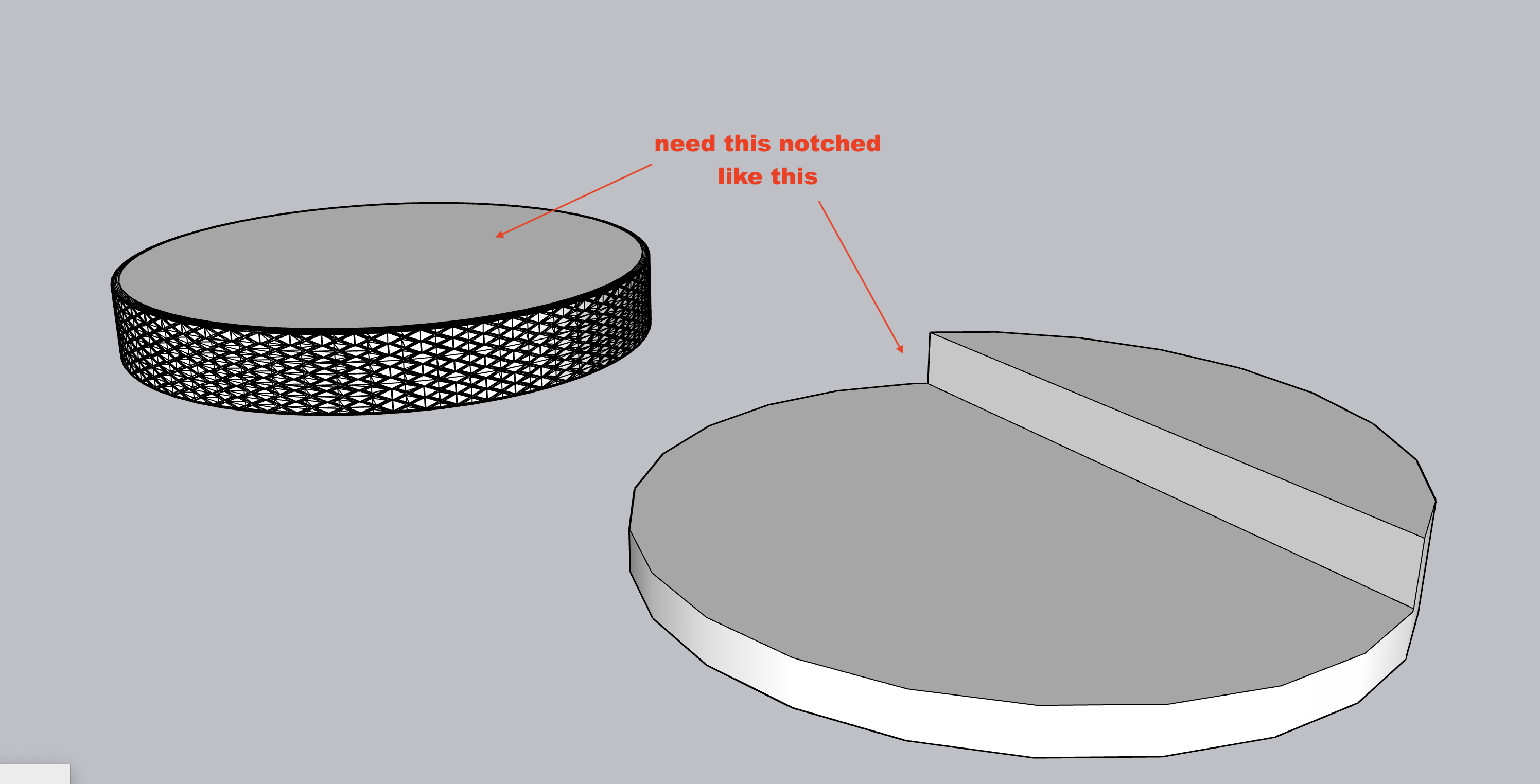

Hi I am trying to take a chunk out of a 3D object (hockey puck) but I am unable to figure out how to do it.
I tried subtracting but it does not recognize the object as solid.
Here is a pick of what I am trying to achieve.
any advice would be greatly appreciated.

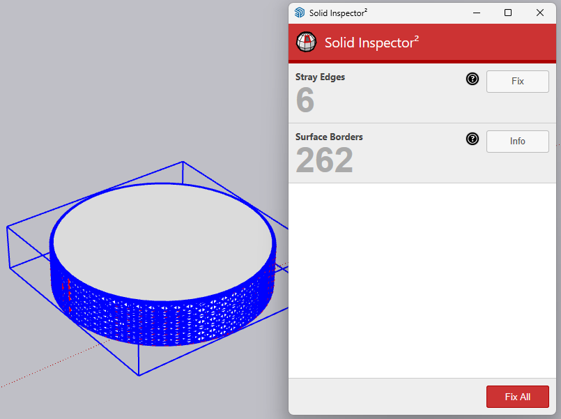

My guess is you received this as an .stl and imported it into sketchup. Problem it shows is lots of holes, these may well have been created due to importing the .stl at too small a scale. Try importing it in meters and see if it is a solid then.
You could attach the original file for one of us to check.
@Box is correct. You should be working at a larger scale. Meters is good because it makes the translation to millimeters, which most slicers use, simple. Also set the model units to Meters and turn off Length Snapping.
This is what Solid Inspector2 says needs to be fixed.
If importing the .stl using meters doesn’t improve things I think it would be easier to create a new model from scratch than manually go through and fix the holes implied by those surface borders.
