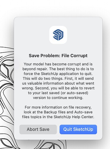

I have an established workflow that involves opening .dwg files in TC and converting to TrimBim, then downloading and importing to SketchUp. This a workflow many others use as the imports are better organized, more complete, and do not contain tagged raw geometry when compared to the native .dwg import function of SketchUp. All in all it’s been a better experience but after the latest 24 update I continually have problems saving files with imported .trb files. The import will go fine but then saving will cause a file corrupt message and a subsequent SU crash. Any other experience of this out there?
Plot Twist: After import if I immediately select all and copy to clipboard, then paste in a fresh SU file it can be saved. It can be worked with, closed and reopened without problem it seams. It’s something about the import process that corrupts the original file but not in the geometry. I’m still working on it.

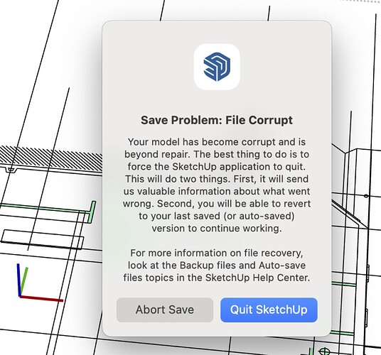

Bumping this topic for the powers that be… I am consistently getting this message with either TrimBIM or .dxf files in SU24 on my M1 mac. They import fine but on the first save SketchUp Crashes without recovery file. This is the message I see… each time if I can remember to copy/paste into a fresh file before the first save the geometry is fine. Something about the import process is corrupting only the original file?
Still happening with the latest version. Anyone else have this problem or just me? Import a .dwg or .dfx or trimbim and it all imports fine, can work with it and modify. But as soon as I try to save or if autosave kicks in I get this “corrupt model” dialogue then SketchUp crashes. It can be avoided by immediately copy pasting the imported geometry into a fresh file then closing the first import file without saving. @colin can you reproduce? I’ll look for a .dwg file that I’m allowed to share that causes it on my end.
I still have this situation, surprising that nobody else is reporting this, lucky me. Every time I import a .dwg into SketchUp the file refuses to save. If it try to save I get the above message about a corrupt file, if I do nothing then as soon as autosave kicks in i get the corrupt message. The only work around is to import the .dwg and (which imports successfully) and then select all and copy paste into a fresh file, then close the import file without saving quickly before sketchup crashes. The new pasted file works fine and can save no problem. ???
SketchUp also recommends that I save as a 2020 to rescue myself, which is a cruel dark irony considering that ability has been removed.
