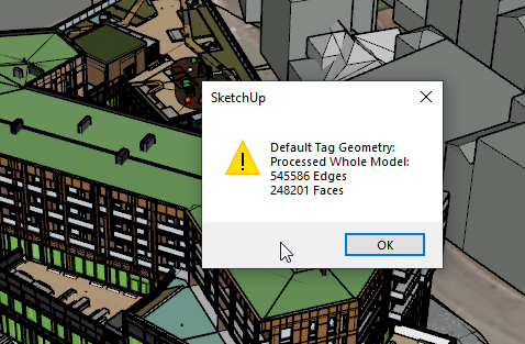

By the way, I fixed the incorrect tag usage in the model. That incorrect usage can’t be making your modeling process easy.

DaveR: How did you fix the tag usage in the model? Is there an extension for that?
Yes. It’s called Default Tag Geometry. Written by TIG, it’s available from Sketchucation.
