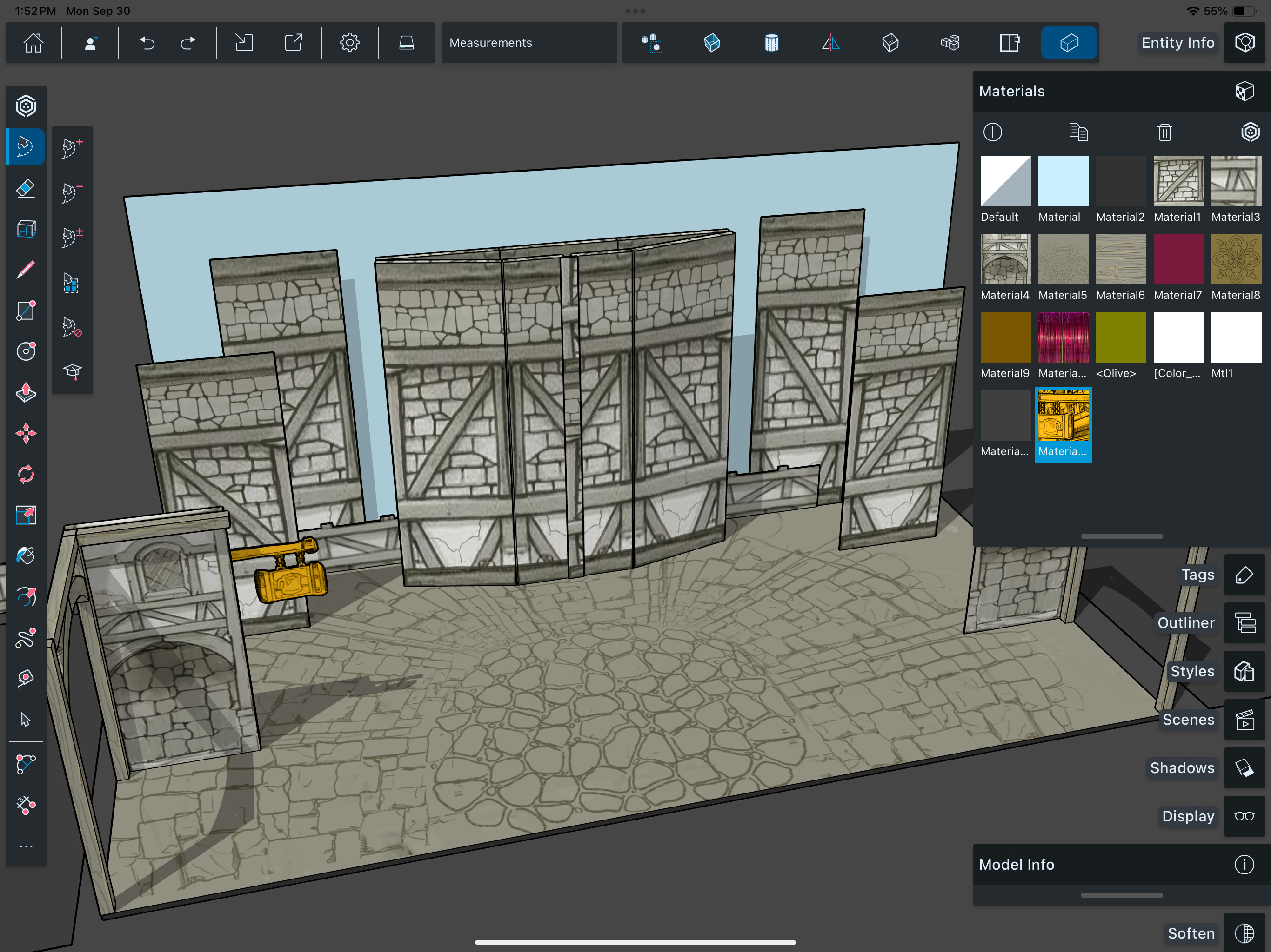

Here is a chunk of my file storage so you can see. I’ve circled three with large texture files. These are theater settings, so there is a LOT of moving components, and full stage murals/ backdrops that I have painted in procreate, turned into a texture and moved into SketchUp.
Even with the hand drawn textures, my files are still nice and manageable.
