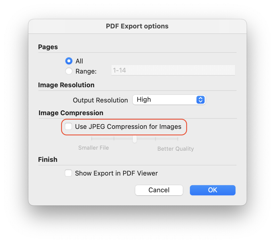

Did you go to File > Export to PDF?
Maybe also press options and check this? (Edit: It should be off)
And to be clear:
For best quality, JPEG Compression should be left unchecked. It produces ugly artifacts especially from raster rendered SketchUp views that have visible edges, profiles and areas of uniform colour. JPEG compression is designed to be used on photographs.
Agree!! I corrected my post. It should be as I show it, unchecked.
Of course, unchecking compression leads to quite big PDF files as the images then use only PNG compression. I have found that then using the optimization functions in a PDF editor can greatly reduce the file size with little impact on quality.
That is generally what I do when I render Raster or Hybrid - Export, then use a PDF editor to reduce file size.
