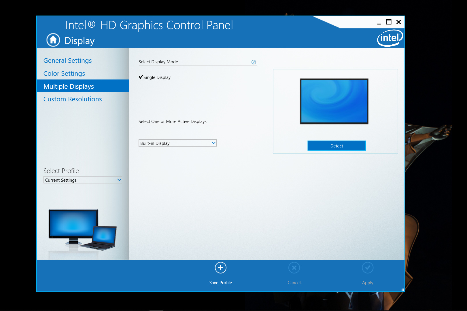

Looks like Nvidia is dedicated to outboard monitor, and Intel is not recognizing it, though I’ve hit the “detect” button to do so.
Trying again - split up for legibility:
Intel Graphics screen
Seems each has taken a screen and one will not recognize the other.
