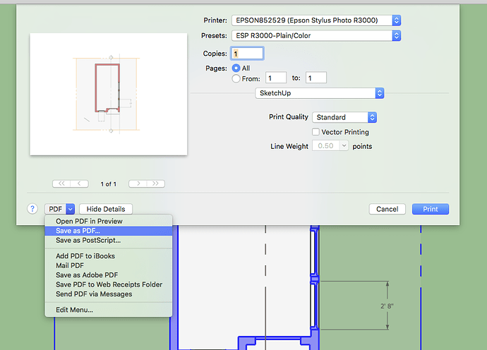

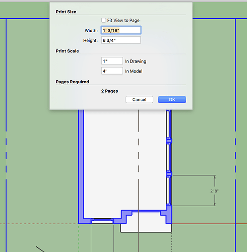

Without using Layout, go File->Document Set Up…
You have to have Parallel Projection set under the Camera menu, and you have to uncheck Scale to Fit in the Document Set Up dialog.
There is a good YouTube video on printing with SketchUp that explains more. This has been there since before Layout, but Layout was created as a better tool for creating printed output. This works for SU Make, which doesn’t include Layout, but is missing from SU Free or SU for Schools.
Also, when you go to print on a Mac, as with any application, you have the option to Save as .pdf. This allows you to create a document that can be emailed to someone who can in turn print it out to scale SO LONG AS they don’t have “Scale to Fit” checked in Acrobat or Preview or whatever else they use for pdfs.
