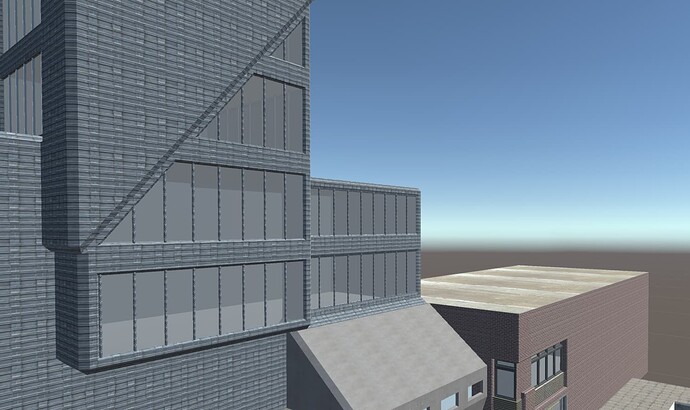

In your SketchUp model you have a lot of infinitely thin walls. That is, there is only one face, and programs such as Unity only draw front faces. You could solve that by modeling walls and floors to have some thickness, where each outward pointing face is a front face. The back faces would not be directly viewable. Maybe that is what is happening. Here is a screenshot of the imported model view from the front, and then from underneath. See how a lot of faces are missing.
front
A different solution would be to export as Collada, and in the options turn on the Export two-sided faces. What you get is the geometry as one file, and the materials as a folder of files. That seems to do better in Unity, you can look at faces from any direction, and the materials come in ok.
