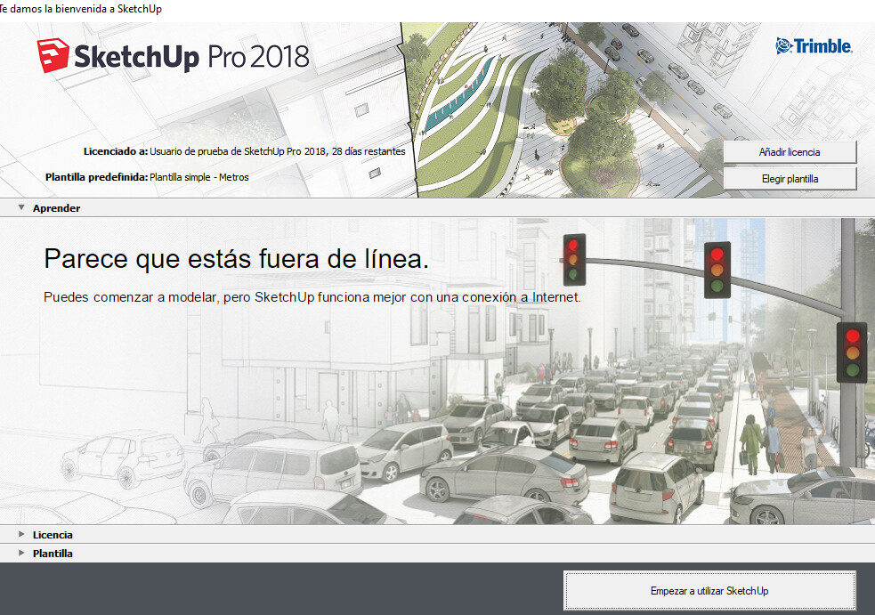

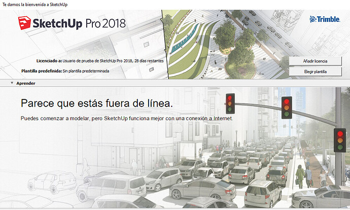

en el skeptchup pro 2018 me dice que estoy fuera de linea y no me deja ingresar la licencia y tampoco el 3dwherehouse

ya hice lo que indican pero no me funciono una parte y no entiendo que dice cuando se refiere a NCR
NCR is a way to force google.com to not redirect to a specific country. Having NCR in the URL, may make the link seem more insecure.
So, change this:
to this:
or this:
Those two are both more secure, because they are https and not http, and for the Google one it isn’t attempting to block a redirect, and so should work better.
Did you close SketchUp before editing the i18n.dat file?
si ya se reinicio y no funciono
ya me funciono muchas gracias
