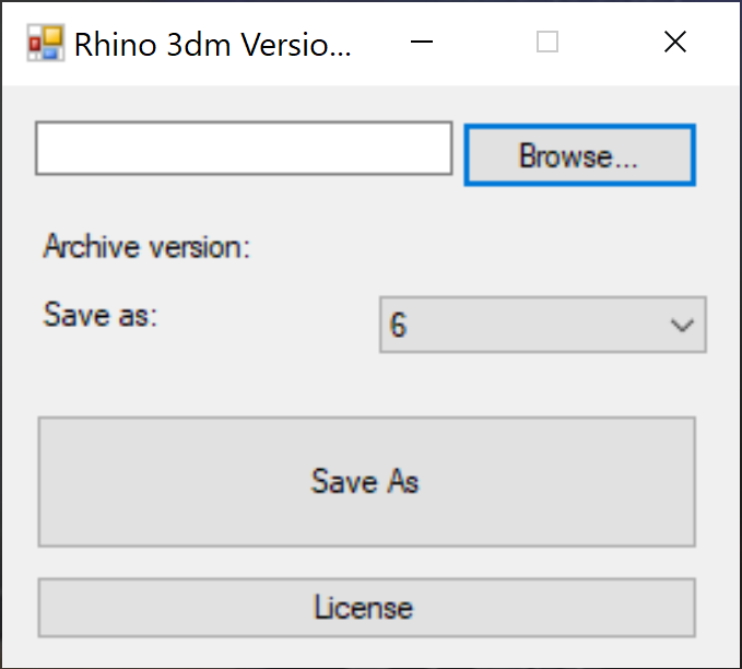

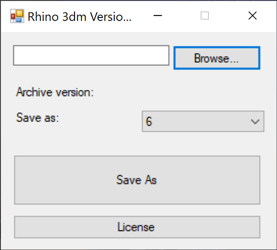

Thanks kabakak, the tool is really awsome. But I want to one tool it can convert skp/3ds to 3dm actually.

It’s not what @steven123 is asking for. It converts Rhino files to an older version format. It doesn’t open SketchUp files.
Thanks Dezmo. I will try it. :grinning:

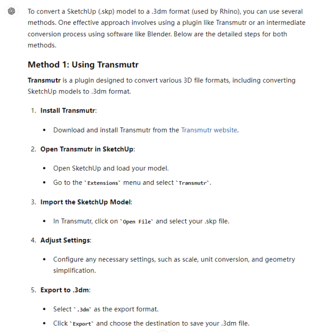

Hello, dezmo. I found an interesting thing, chatGPT told me Tansmutr can convert skp to 3dm. But I tried to install Transmutr and could not find export 3dm item
ok, once more for the ones in the back.
chatGPT is a moron.
if you check the website, at the bottom you can search for terms, and searching for 3dm or thino only brings up a thread from 2019 where people ask for the same as you do.

ChatGPT is unabashed in lying.
It’s up to you whether you trust your own experience or your fellow forum members, or rather a machine whose true intelligence is less than that of a monkey or a crow.
