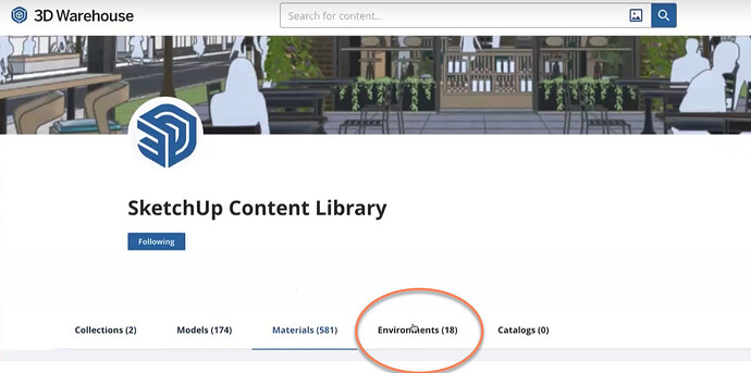

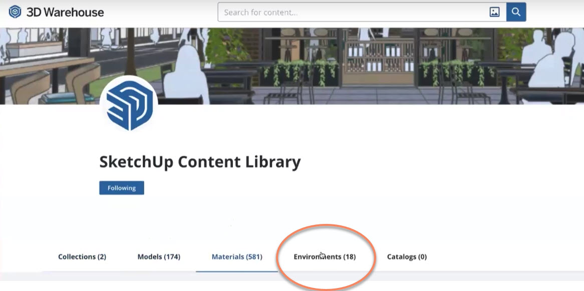

When I upgraded to the 2025 version I remember I was asked to switch to the Content Library but I ignored it at the time and kept the traditional 3D Warehouse. As a result, I cannot the see the Environments tab (see the attached screenshot).

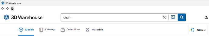

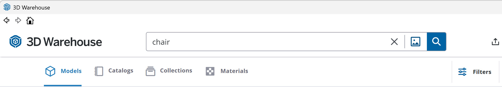

Yes, I’ve found environments simply by searching for them. But how do I add the Environments tab up to where Models, Catalogs, Collections and Materials tabs are?

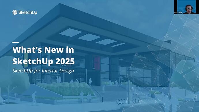

Hi DaveR, I’ve seen it in Webinar 3 Live recording made by the Sketchup team
The option to see the SketchUp Content Library is in your profile menu, in case you want to go back to it later. Choose SketchUp Libraries, and then you will see the Environments tab.
