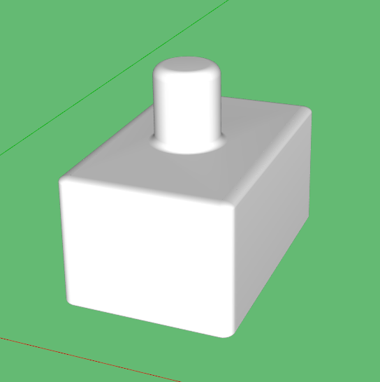

Umm
Cube
OK try that with this now
Moving the goal posts.
Explain how you did that?
I did the same for the block but reduced the rectangle down, then did the cylinder as a separate follow me.

Nice work. And that is how i would have done that as well. But my point remains. There is no native tool in Sketchup shop to do this with where in other CAD programs they are included as standard. Either for free or at a lower cost that you would pay Trimble. I am not saying that it cant be done im talking about what you get out of sketchup for the money you pay.

Every tool @box used is a native tool available in any version of SketchUp… Pro, Shop, Make, or Free.
