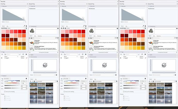

Something I’ve noticed over the past few weeks is that my tray in sketchup does not retain its size. This is my default tray height, my tray sits separately on another monitor:
As I close and open Sketchup throughout the day, I notice that little by little, the tray height gets smaller and smaller (width stays the same). It’s a minor inconvenience but thought I would bring it up. Here’s an example of it after opening Sketchup 3 times in a row, you can see how it moves up from the bottom a few pixels each time:
After awhile, you can see a noticeable difference, and it starts shrinking from the top-down as well, not just the bottom-up:
Just an update to this, I realized it’s happening to my floating “Default Tray” as well when it pops up as I soften edges, on my main monitor. I’m pretty sure I’m not actually resizing it. :frowning:
