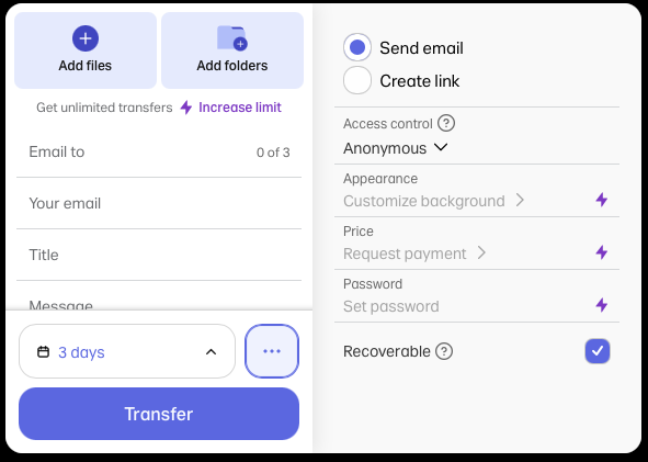

I use wetransfer.com for most times I send a file. If you go there you do not have to sign up, you only have to agree to their terms. After that, when you get to the screen where you can add your files, look for these dots:
Clicking the dots lets you change from Send email to Create link.
