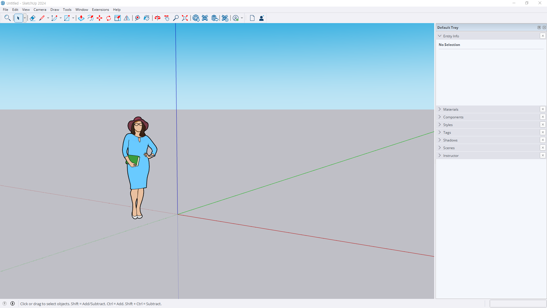

For example, take a look at the image below.
my sketch up pro 2023 viewport.
my sketch up pro 2024 viewport.
I’m wondering if I need to redo all the settings every time I update the version, like in this image. It’s very cumbersome and exhausting to go through these steps every year with each new version of SketchUp.
Yes, you do.
Extensions are installed into each version of SketchUp they do not carry over from version to version.
The good news you only need to do this once, it will take you a few minutes to reinstall your extensions and fiddle with your toolbars etc…
