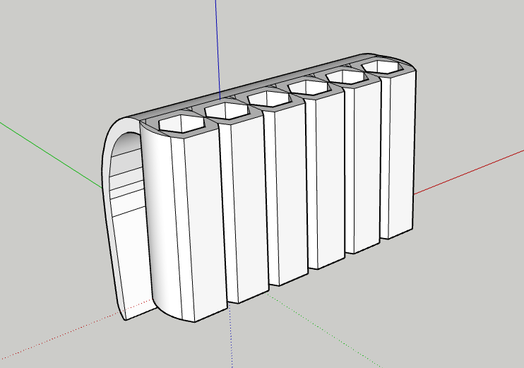

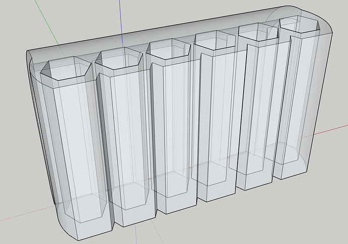

There are a lot of internal faces and some stray edges. If you switch to the Xray style you can see those inside the object.
When you get it cleaned up it should look like this.

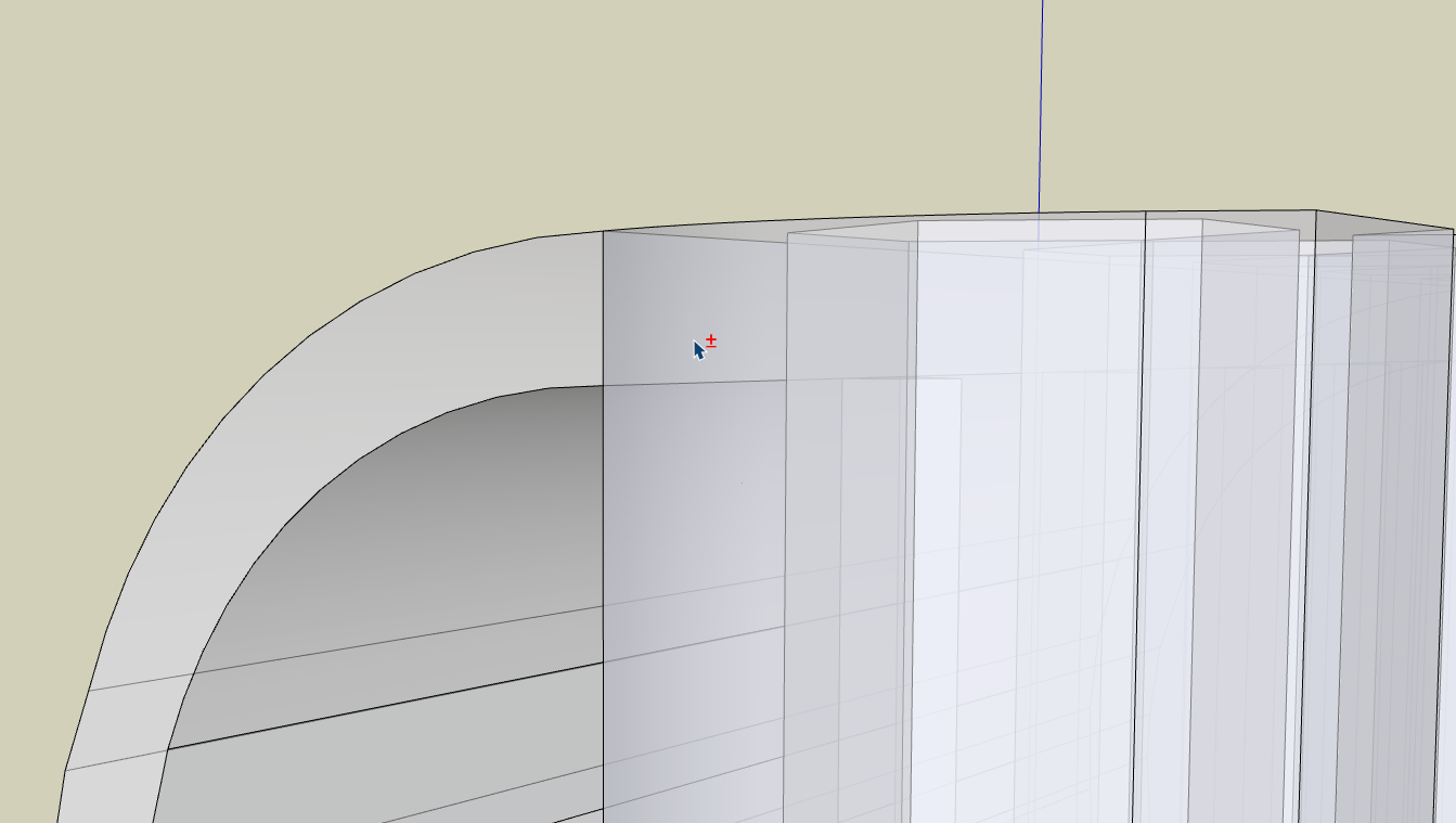

Pretty good. You missed an internal face at the top. My cursor is over it in this screen shot.

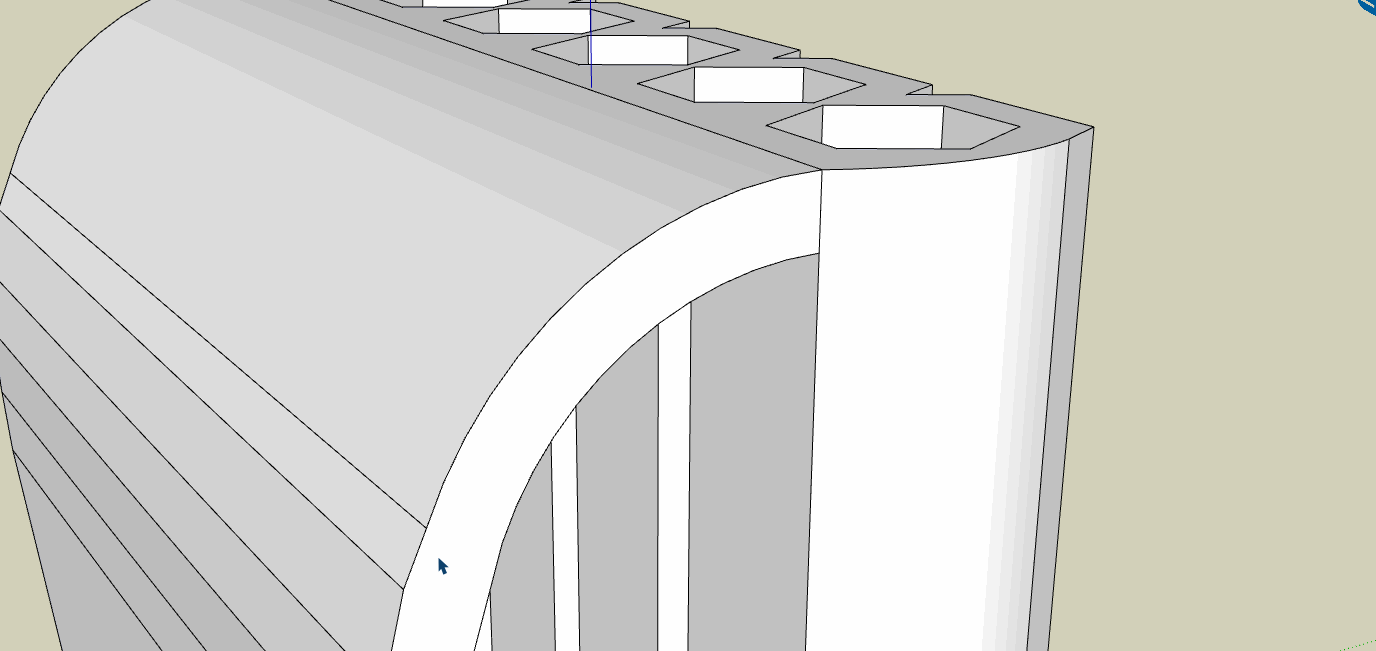

Hide the face on the end and then you can select and delete the face inside.
intface

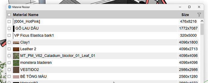

It is overburdened with entourage.
I fixed incorrect tag usage.
And purged unused content.
And reduced excessively large textures.
