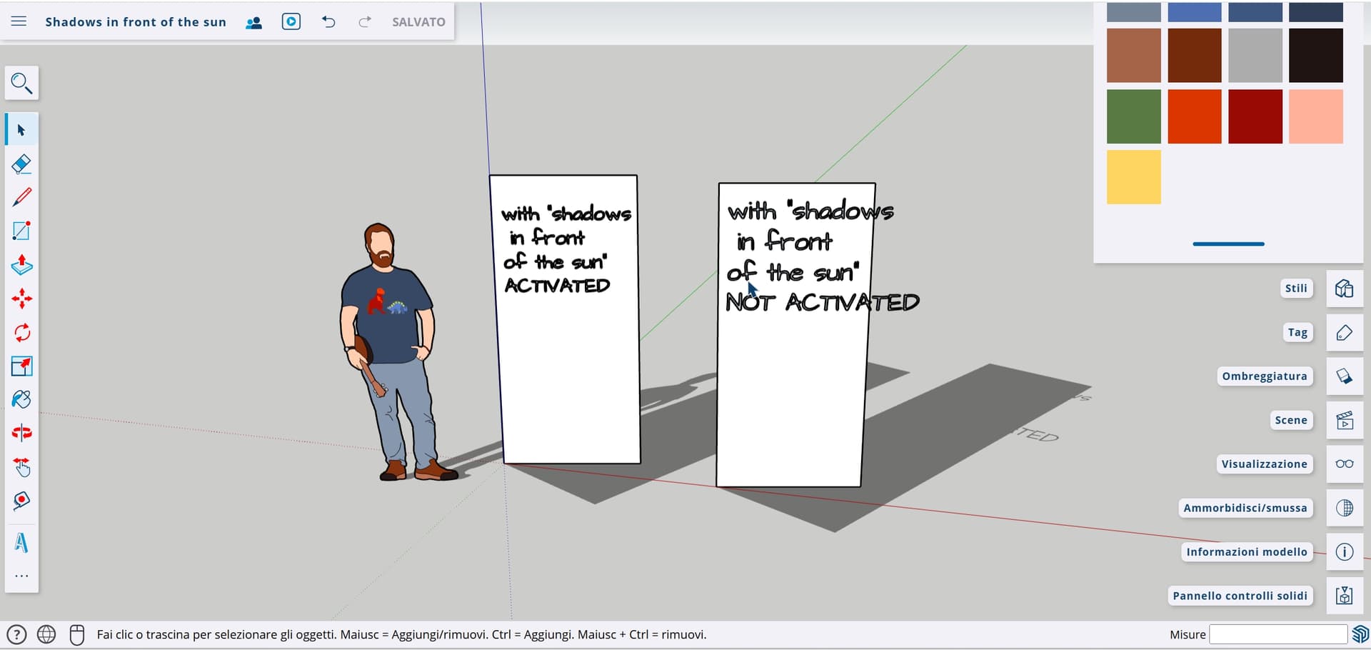

I’m sorry but I found an other “bug” in SketchUp Go, Shadows in front of the sun doesn’t work correctly, I think. On the left the component without the feature, and on the right the component with the feature turned on. They have the same behaviour.
First part of the gif > SketchUp Pro
Second parte of the gif > SketchUp Go

In the window that appear when you create a componet, there is this feature, that I know how is working in SketchUp Pro, but isn’t in SketchUp Go!

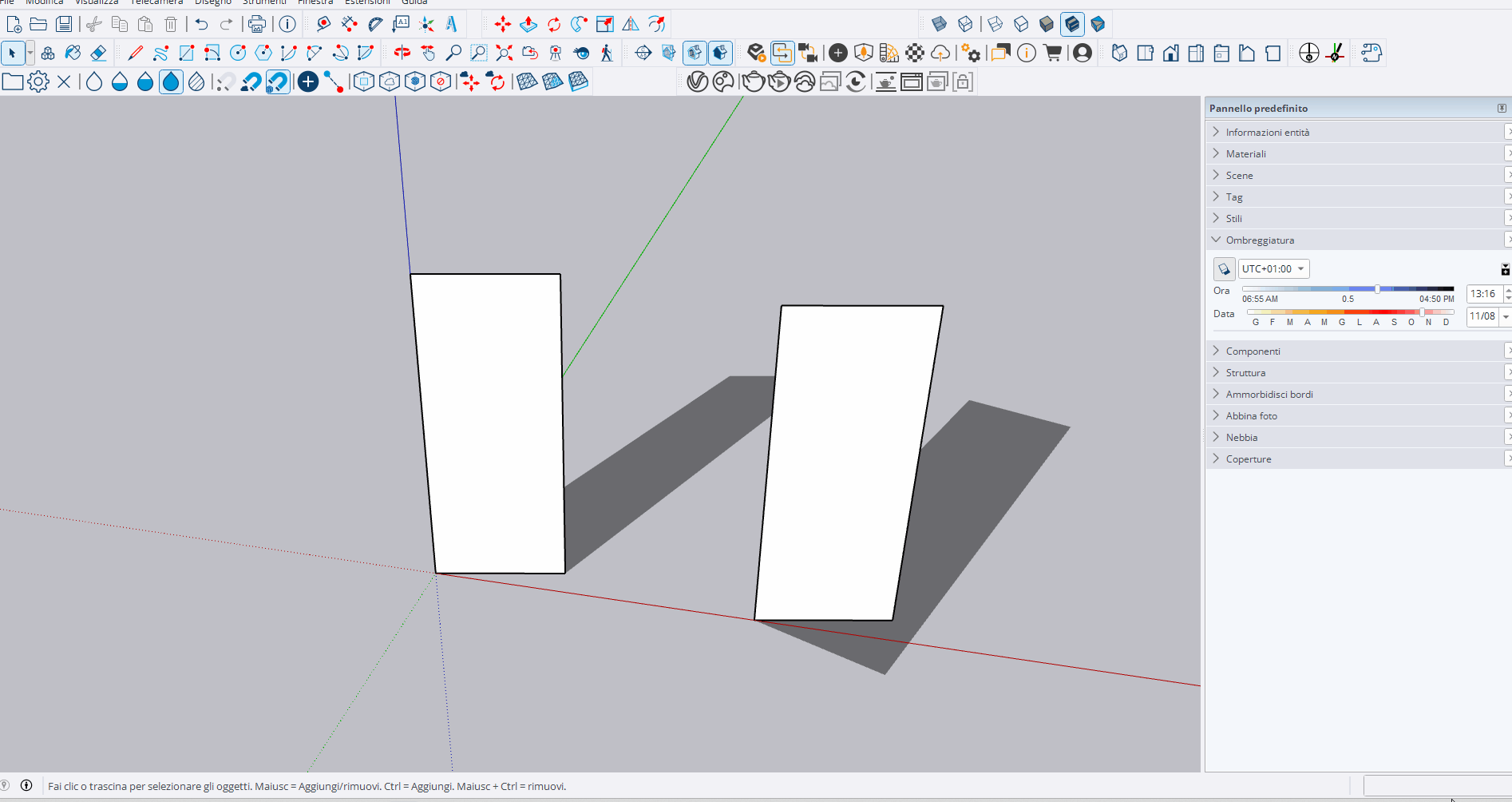

When I opened the file in Pro, both components had their “shadow faces sun” setting enabled. I disabled that for “componente#2”, saved and opened the file in the Web version, and it works as it should.

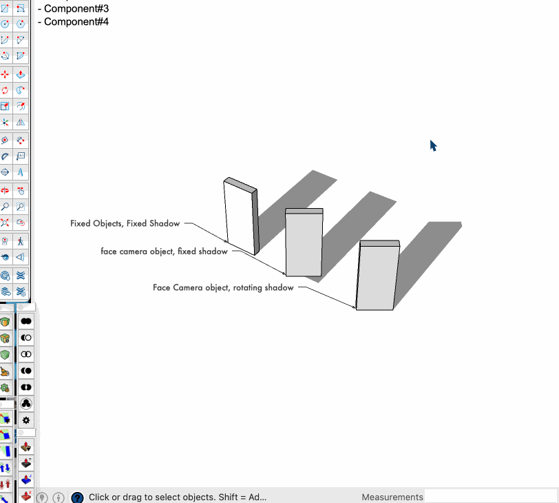

I’m not so sure, I think this may be a bug in the current Web version. There are essentially three states possible, fixed component with fixed shadow, facing camera component with fixed shadow (shadows face sun selected) and facing camera component with rotating shadow ( shadow facing sun deselected) better described as shadow calculated by real time position of facing camera component as the camera moves.
In SketchUp Pro I can create all three and they work as expected.

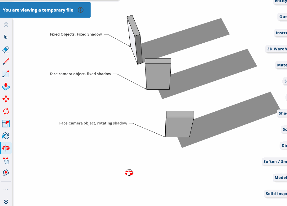

If I import that same file into SKetchUp for Web, the three work as expected.
However, if I create all three types from scratch within SKetchUp for Web the option to have shadows not face the sun but be calculated by the position of the camera facing object does not work as expected. Even with that option deselected, the shadow remains fixed?

You are right. When creating the component as ‘Always face camera’ keeping the option ‘Shadows face sun’ deselected is not honored. It will be ticked anyway. That is the bug.
One can later untick the option ‘Shadows face sun’ in ‘Edit component details’ in the ‘Components’ window to then work as desired.
