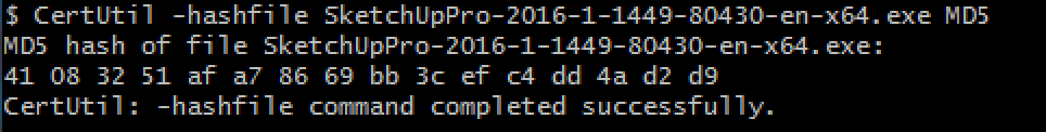

You did download from sketchup.com/download/all, correct? Any chance you could check the SHA or MD5 on your installer?
I can’t say with any degree of certainty, but typically I install SU using the link that I get from the auto-email telling me that a new version of SU is available, and has all of the licensing info.
As for the installer (the .exe file that I initially download?), it’s long gone, so I wouldn’t be able to check any of its details. I can say for sure that I didn’t run it with the “Run as Administrator” option, so I may’ve sealed my fate years ago…
