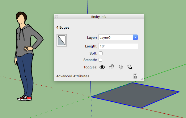

Being able to select just lines or just surfaces is valuable. (I’ve played with ThomThom’s selection toys, but haven’t gotten far with it yet.)
The Entity Info window shows different info and gives access to different info depending on the mix of the selection.
Mixed lines and faces:
28 PM
Just faces:
17 PM
Just lines:
39 PM
Only when you have just faces selected do you get access to both the front face and back face material selection.
