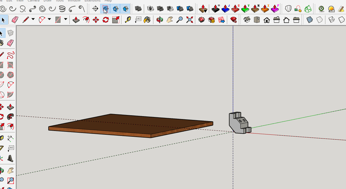

How does one create a section cut of ONLY one component or part in SU?
IE, i have 2 components in model space; a wooden base, and a block. I try to just section cut the block but it does both the base and part.

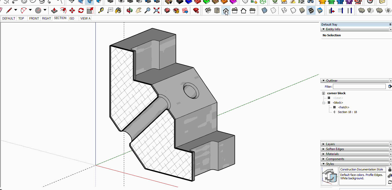

use inside the group or component…
john
wow! its that simple. Though to be honest, i never use section cuts so didnt think it could be done INSIDE the group or compoent. good to know. thanks.
