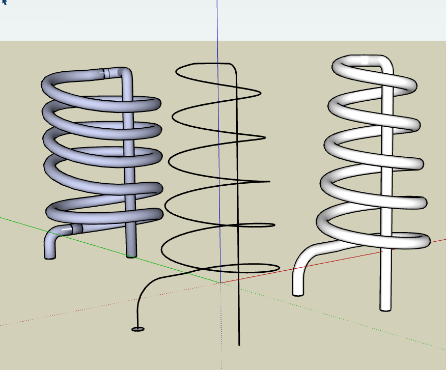

How to scale a tube spiral to make it more narrow at the top? I want to make it slightly conical, and I have no idea!

Ok. So your tools are limited. You can’t really scale the top of your spiral without affecting the whole thing. I would suggest modeling a tapering spiral to use as a Follow Me path instead. That way you can get the tapering spiral without having the tube become deformed in the process.
This is a quickie example.
FWIW, if you upgrade to the desktop version there are extensions that make quick work of modeling the tapered spiral path. The web based versions don’t have any facility to use extensions, though.
Ok, thanks for your reply. I don’t know yet how to make a tapering spiral, I’ll have to dig into that.

Did you make the spiral to the right just now!?
Good luck with the tapered spiral. You could start by drawing a cylinder and scale just the top face to make it more cone shaped. Then draw your spiral around it.

Yes. I drew the tapered spiral with an extension in the desktop version of SketchUp, though. I just extended the ends with Line and 2-Point Arc to make the full path.

Any chance you want to share your spiral it’s just what I’m looking for. Trying to illustrate cooling channels inside a 3D printed steel mold.

Here you go. No idea if it’s correct.
spiral2b.skp (869.0 KB)
Thanks! It’s to show how you can make more effective cooling in 3D parts
