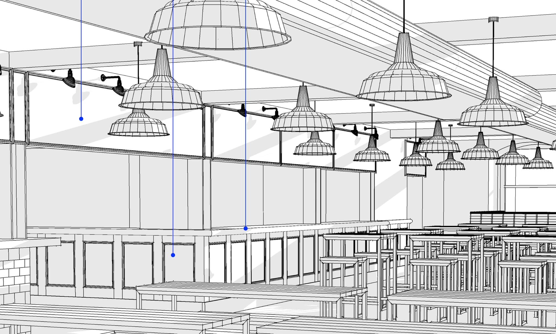

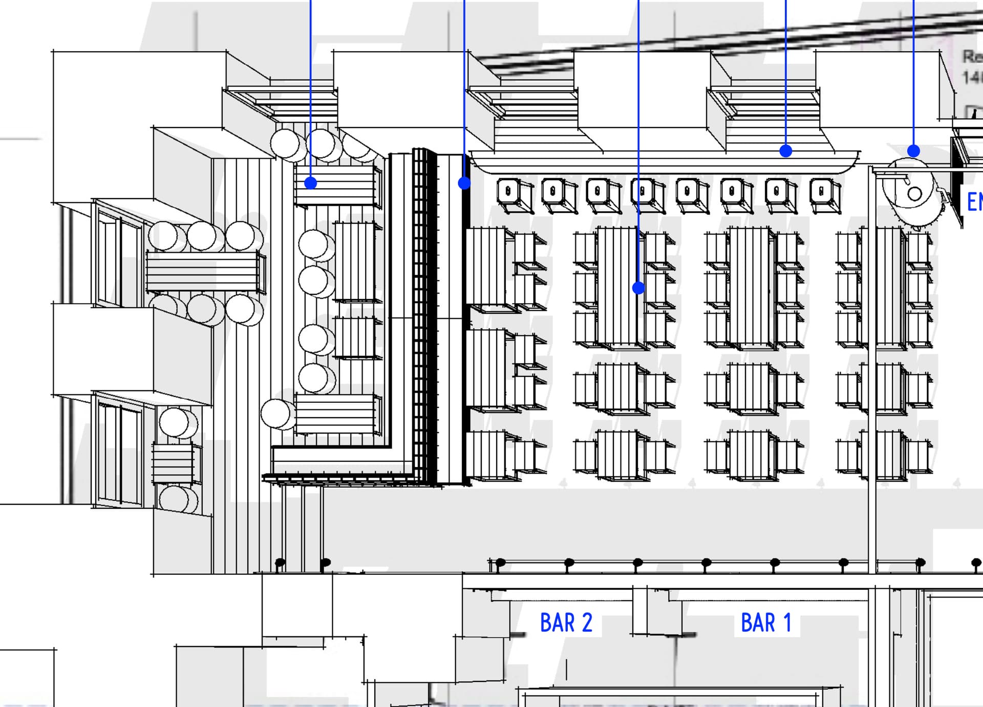

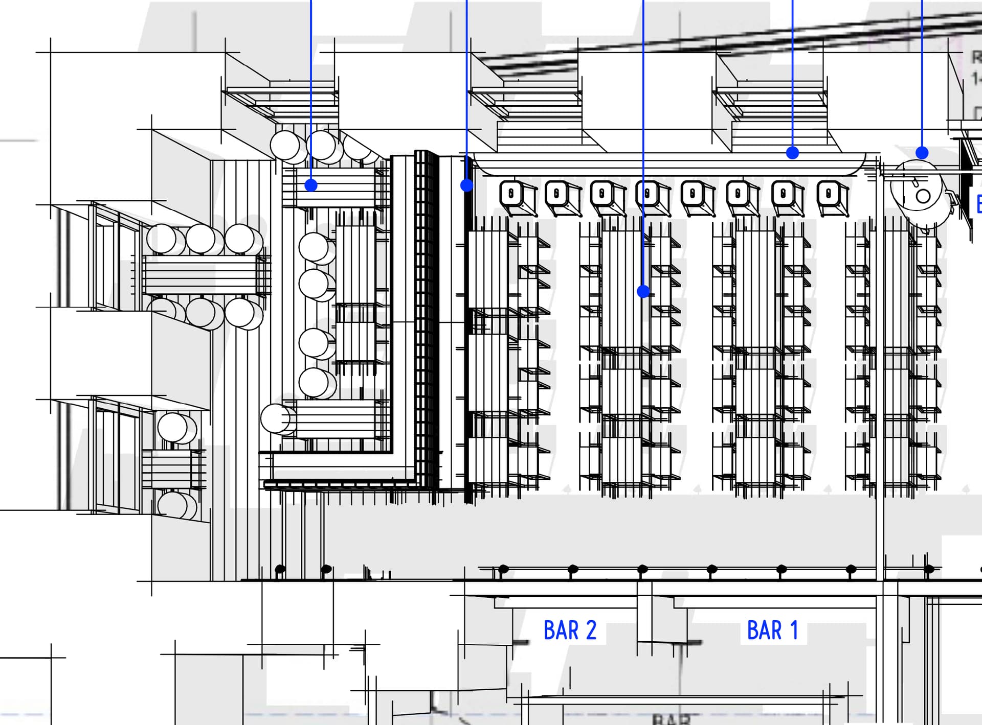

Hi Colin, the line quality is obviously great in the Hybrid Override Output version especially any diagonals, however, the style I use at this stage for these sketchy b&w shaded images has quite a big line extension setting (6) which is ok in Raster output mode, but the Hybrid mode has the line extension render far longer than it appears in the working model scene image and actually makes for a worse exported image.
Obviously if I know that I can reduce the extension setting for a hybrid output, but then my in model version doesn’t appear with any extension. These three screenshots show the differences…
This is a screenshot of a 3d plan scene in SketchUp (with Edit Resolution set to High - It turns out I had been in that settings window when i noticed the edit resolution of my logo image in Layout being reduced, but hadn’t noticed the Override thing) :
This is the Raster export which actually shows less line extension:
And then this is the Hybrid export with crazy line extension that spoils the image:

Model scene screenshot:
