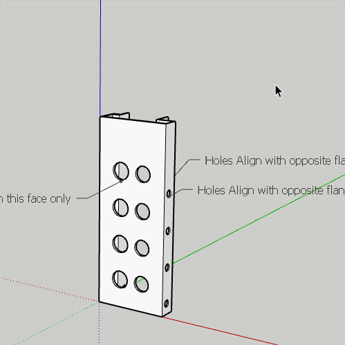

You can use dumb components, the rails without all the holes for example, then replace them with the full components when wanted, they can even be on a tag that is turned off and on as needed.
Depends what it is, but if it was like the one you posted before, copy the end face out of the original, then pull to length and don’t add the holes, make component, done.
Here’s a quick example. Copy and paste in place will be in your edit menu, not the right click menu like I use here, you can set them as keyboard shortcuts.
I have moved the copy to show you it is there but you can leave it in place and assign it a different Tag.
