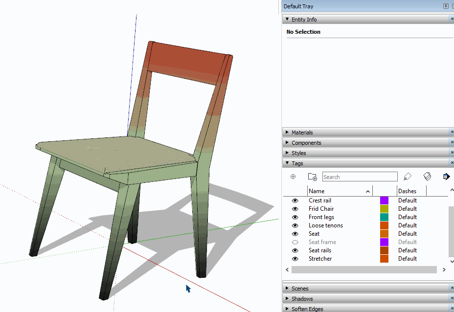

I am confused on how to change the tag of objects.
Say I have a chair.
I can change the tag of the chair object easily, but the dozens of groups and components (as well as the hundreds of lines and surfaces) in that object will now be out of sink with the object and this will produce weird buggy behavior. And changing them all individually will take hours.

The edges and faces should already be untagged. They should always be left untagged. And there’s no need to tag the groups and components of the chair if the chair is a nested object and has a tag unless you want to be able to show or hide parts of the chair but then all of those parts would need a different tag than the parent object. Most likely you would just open the chair for editing and select the groups/components inside and change the tag to Untagged in Entity Info.
tags
If you’ve tagged the edges and faces in your model, get a plugin called Default Layer Geometry from Sketchucation and run it to remove the tags from the geometry.

The correct workflow is to leave Untagged active at all times and leave all edges and faces untagged.
If you follow the correct workflow it will work correctly. It’s also a whole lot easier and less likely that you will induce errors.
There is no reason to tag thhe edges and faces in the model. Only groups and components should be give tags.

Default Layer Geometry removes the tags from the edges and faces and sets them all to Untagged. It only removes tags from edges and faces. It isn’t intended to change tags given to the groups and components in the model.
There isn’t a more “forceful extension”. You can select all of the child objects and change to Untagged as I showed you. Alternatively you could delete the tags and choose to set everything to Untagged in the process.
