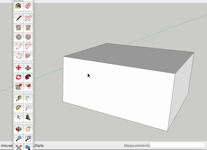

When using many of the SketchUp tools with precision in mind, my actions tend to follow this process
- First… I inform SketchUp what the positive action direction should be
- Second… I provide the precise measurement of the action.
The gif below is an example …
- The first rectangle I pull the surface out (This tells SU what the positive direction should be)… then I type in the positive direction.
- The second rectangle I push the rectangle in (… this tells SU what the positive direction should be)… then I type in the same values as before.
- For the third rectangle, notice that I push the rectangle IN (telling SU what the positive direction should be)…BUT I type in a negative number… which is the opposite of my assigned positive direction.
I hope this makes sense and that it helps
