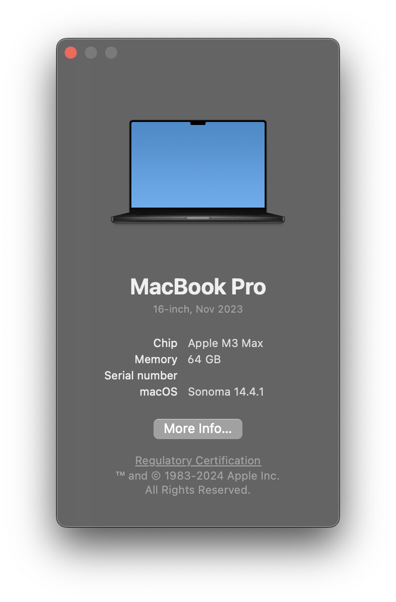

I’ve experienced every one of the issues being reported while testing SU2024 (see profile for specs):
  • fragmented transparency and freeze with anti-aliasing set above 0x
  • blackened components until moved or rotated
  • blackened ā€˜Place 3d text’ (extruded or not) until it is moved
  • freeze when adding materials to the color panel (materials palette)
  • kernel panic
I was going to upload my .panic file but it’s gone after sending to Apple. It’s not in my /Library/Logs/DiagnosticReports/Retired folder, nor can I retrieve it in console or terminal. All I have is my .shutdownStall file related to the kernel panic.
I’ve just gone back to 2023 and I’ll wait for a couple of updates to 2024 when it’s actually functional.
