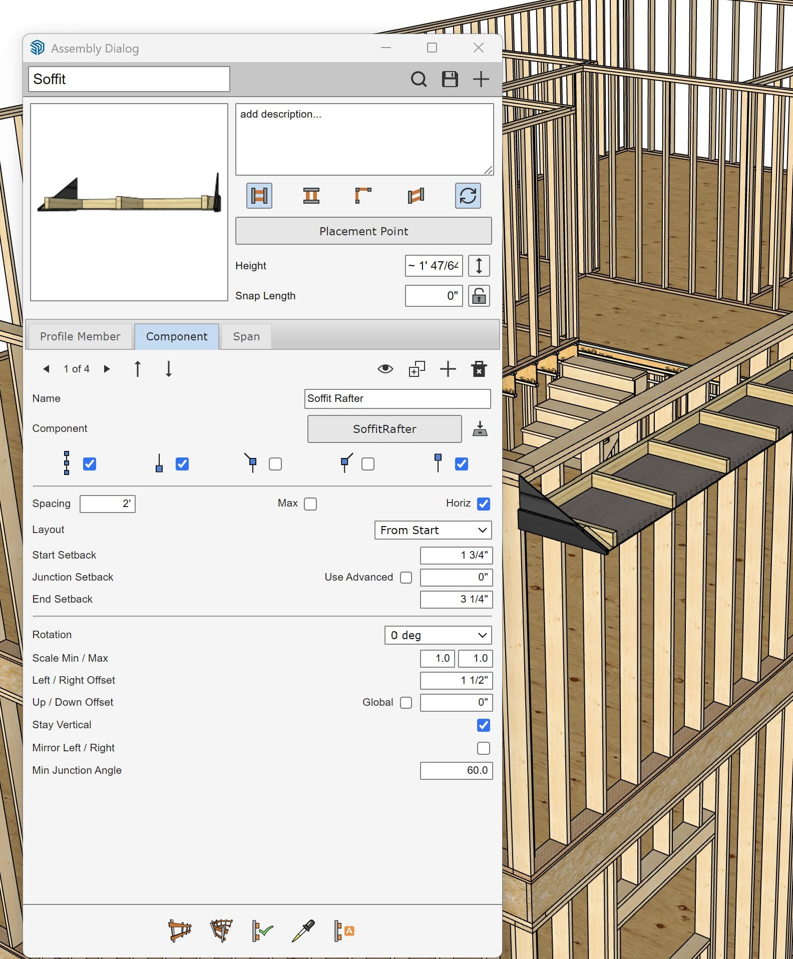

I will contribute a PB4 assembly that someone might find useful. It creates a flat soffit with framing, It fits in a 24" overhang and has James Hardie Vented Soffit Material.
Soffit.skp (424.1 KB)

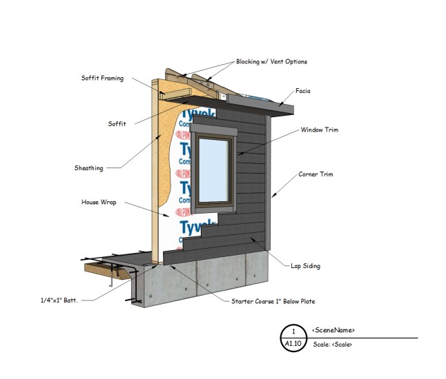

There are different theories in how we present details in our drawings. Some hold to an old school 2d black and white detail, I my self like 3d and color to better tell the “story”.
I also like to use framing elevations to dimension things like Plate height that are usually noted standard elevations with fully clad walls. This is why I created this PB4 assembly.
I would say I have a lot to learn about Profile builder and am thankful for this conversation!

Very cool assembly! Thanks for sharing it!
