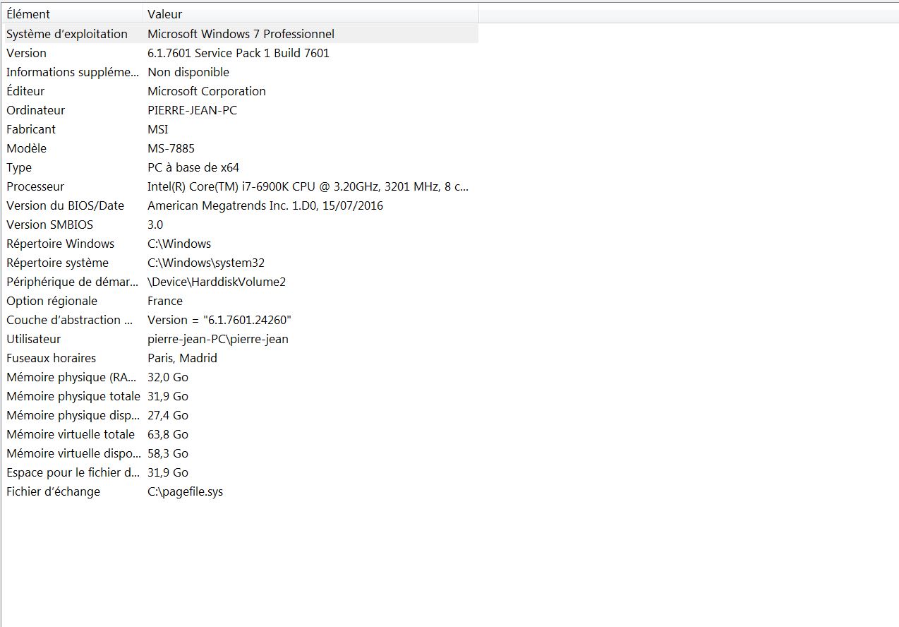

if the problem persits, launch the MS Info tool (which is silently used by SU Checkup) and check what is reported there: “Win+R > msinfo32”
Alternatively you might want use the MS DXDiag tool: “Win+R > dxdiag”

which problem, does MS Info or DXDiag show the same wrong information.
simply ignore, the wrongly detected information of the Checkup tool does not have any influence on running SketchUp.
If you have issues inside SketchUp (or Layout) describe them preferrably in a new post.
You did mention some issues within SU, so can you share the MS Info and DXDiag screen captures?
