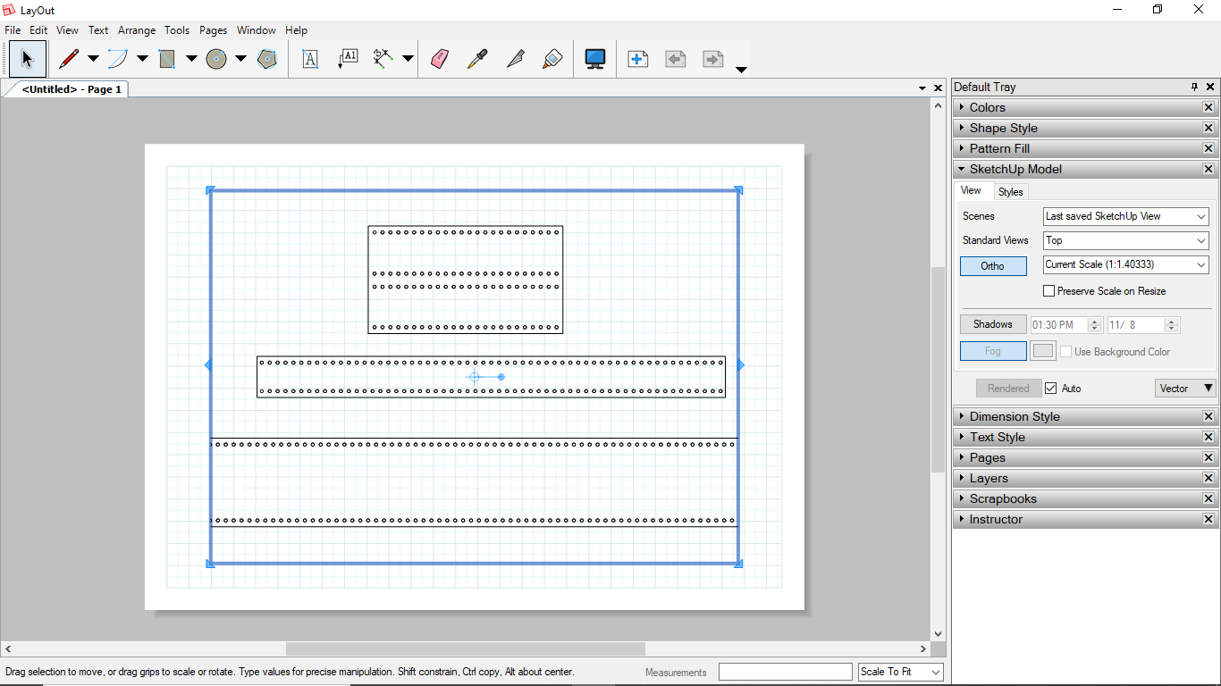

Sorry. I also changed the background color in the style in SketchUp to white and updated the style.
Which version of SketchUp and LayOut are you actually using?
2015 Pro
Not quite. It wonât print full size if thatâs important to you. The scale isnât set to 1:1.
It would be wise to create a scene in SketchUp for the view of those patterns. As it is you are using the Last saved SketchUp view for that viewport. If you make any changes in the SketchUp file and save them, youâll ruin the view of your model in LayOut.
I did set it afterwards
