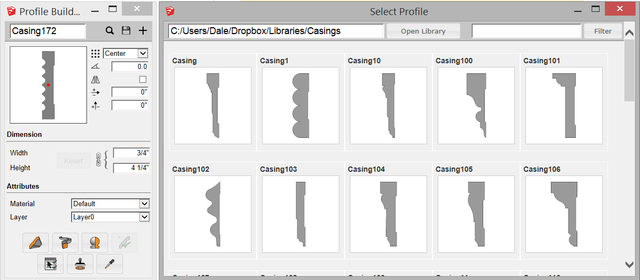

When push-pull does not meet the need, perhaps try followme along a path.
I think Profile Builder was created to do trim originally.
https://extensions.sketchup.com/en/content/profile-builder-2
