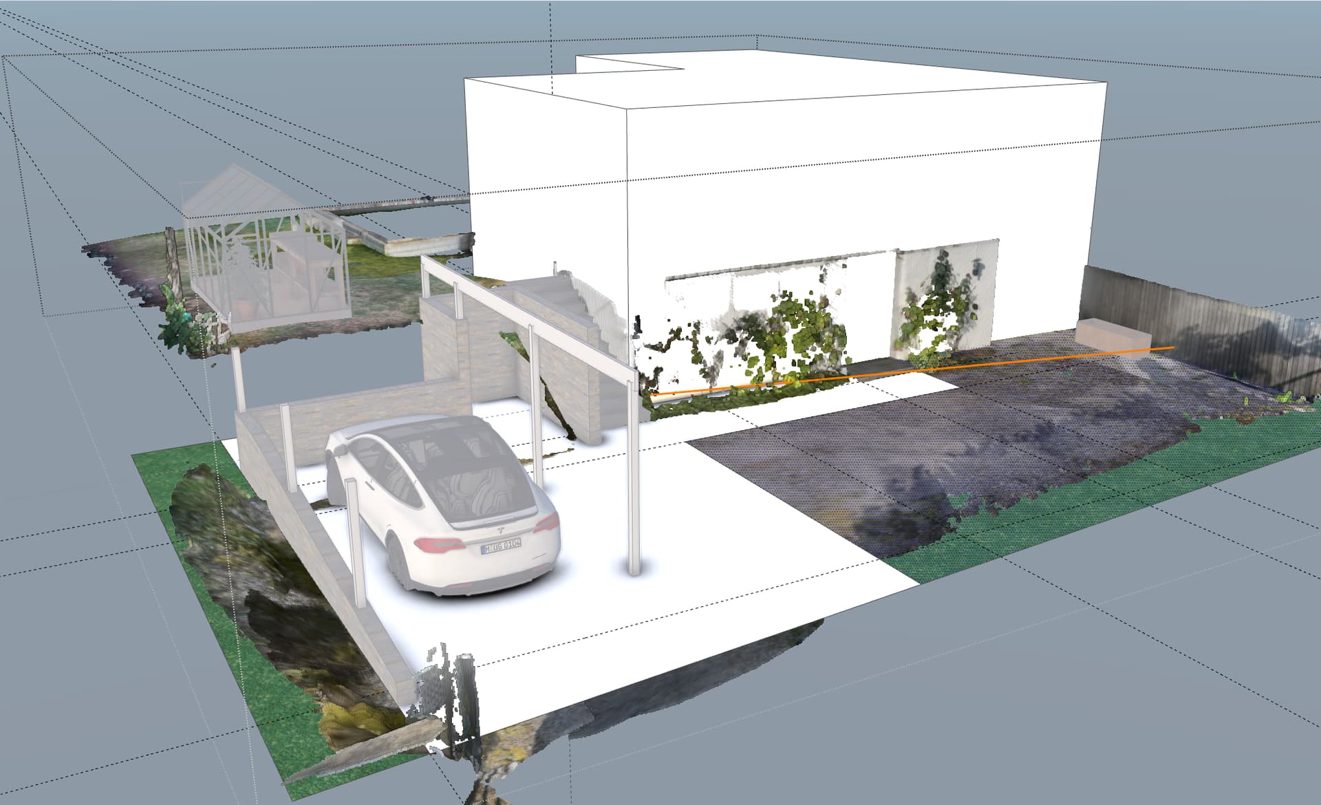

I am modelling on top of a pointcloud and as seen in this picture the pointcloud is visible through the grass-texture i applied, but not through the rest of the model. The grass and the white model are in the same group with no subgroups. Why?

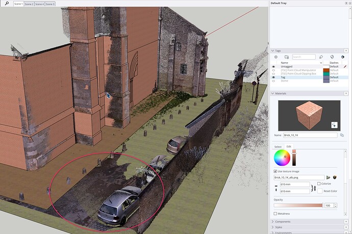

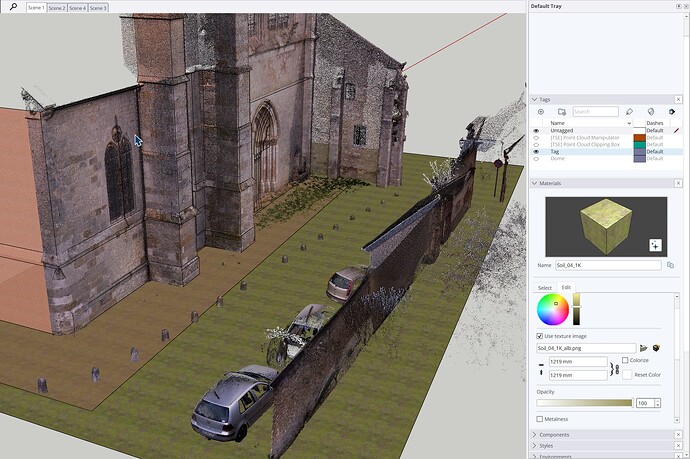

To highlight my thoughts here is an example :
In this first screenshot, the wall has a brick material with opacity 100% and the ground a grass material with opacity 75%
The second image, at the opposite as a brick opacity 90% and grass 100%
