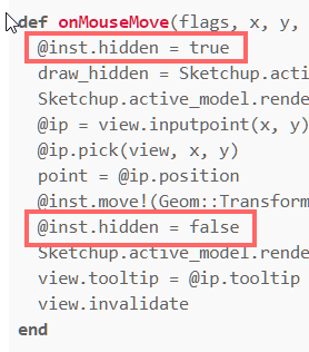

OK I got it working using your example DragTool, and hiding the component during the pick.
def onMouseMove(flags, x, y, view)
  @inst.hidden = true
  draw_hidden = Sketchup.active_model.rendering_options["DrawHidden"]
  Sketchup.active_model.rendering_options["DrawHidden"] = false if draw_hidden
  @ip = view.inputpoint(x, y)
  @ip.pick(view, x, y)
  point = @ip.position
  @inst.move!(Geom::Transformation.translation(point))
  @inst.hidden = false
  Sketchup.active_model.rendering_options["DrawHidden"] = true if draw_hidden
  view.tooltip = @ip.tooltip if @ip.valid?
  view.invalidate
end
I now have an issue that nothing is updated until I stop moving the mouse.
OK I finally got it working. I had to use a timer or the component wouldn’t be drawn until the mouse stopped moving. This was due to hiding the component so the input point wouldn’t pick a point on the component. This is the best solution I can come up with at this point. It’s still not as smooth as moving without hiding the component, because of all the extra work, and it seems like a bit of a hack. I’d welcome another solution (other than hiding) to exclude a particular component from the pick.

Just my note:
The onMouseMove called every time when the mouse changing its position pixel by pixel (when x, y is different than the previous)
So this piece of code happening within milliseconds reading from top to bottom repeatedly and “telling” to the sytem to hide-un-hide-hide-un-hide… all the time.
Until you are not mowing the mouse then the last “command” is un-hide.
I don’t see much point using like this.
