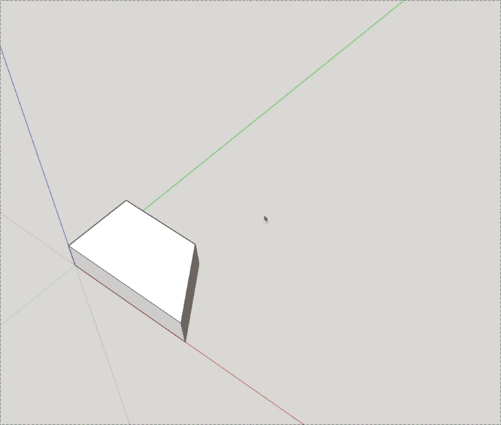

Hello,
In a customized move tool, I would like to hide the moved component instance until the user click on the destination point to be able to draw only its skeleton.
I tried the following trick :
instance.move!(Geom::scaling(0.0))
It seems to work as expected on current SketchUp versions, but it uses a null matrix that may be a problem for the future.
Did someone find a better way to temporarily hide a component instance ?
Enregistrement de l’écran 2025-09-16 à 11.12.41-GIF 720x720 15 ips

Yes, but by drawing only the skeleton, it is easier to target a point that could be behind the moved object.
Use X-ray image :stuck_out_tongue_winking_eye:
Of course, it would be nice if we could apply it to just one instance in Ruby, like the Move Tool is doing it… :slight_smile: (Changing the material and back of each face would be too intensive task for pure Ruby, I think.)
