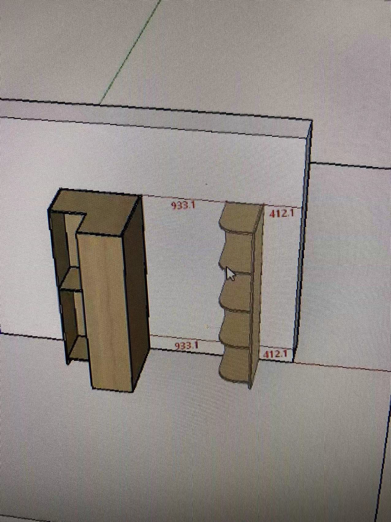

Hi,could you share the source code to me please?I meet this problem but i do not know how to catch the page , caculate the distance and note it.
BRs
LongHou
It’s part of a proprietary extension. My move tool is 1,250 lines of poorly documented code that would be very difficult for you to understand with out the rest of the code in my project.
Instead why don’t you start a new thread showing what you tried and the specific problems you run into as individual questions.
For example you will get better answers if you ask questions like “How can I calculate the distance between two points” (Answer: point1.distance(point2)) You will get quick helpful answers.
On the other hand if you ask questions like “How can I make an extension to draw trees at random intervals?” You will likely receive little or no help.
I already raise the topic and someone link your topic into.I do my best but did not get progress,so ask help to you.I am blocked by this function and more anxious.
If you can share your code I’m willing to pay some fees as compensation.Thank you in advance.
Can you explain exactly what code you are looking for? I’m not really interested in selling the code for my entire move tool.
I already posted the code to exclude the component from the selection here.
Does that code not work for you or is there a specific problem you are running into?
I can drag the component and move.But I dont know how to capture another component and caculate the distance.drag.txt just can drag and move the selected component.
I see you had implement this function.
I want to consult with you how to implement this function.
drag.txt (2.4 KB)
You might want to look at this thread.
Thanks for your quickly response.I will try it.
