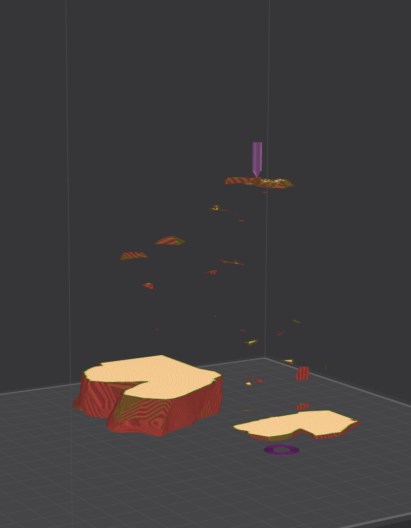

Parts become missing when imported to Creality Print
update.stl (371.5 KB)
Once i try to import it to a 3D software half of it is missing is this a sketchup problem?

The thing isn’t a solid object. In order to be 3D printable it needs to be considered manifold or solid. That requires every edge be shared by exactly two faces. So not holes to the inside, not tray edges, no internal faces. And also all blue back faces need to be oriented toward the print media.
YYou need a surface to cover the open side as well as ones to fill in the missing bottom faces. you need to correct face orientation and if the stepped faces on the underside are required, you’ll have to figure out what to do with that face extending down to the groundplane on the right.

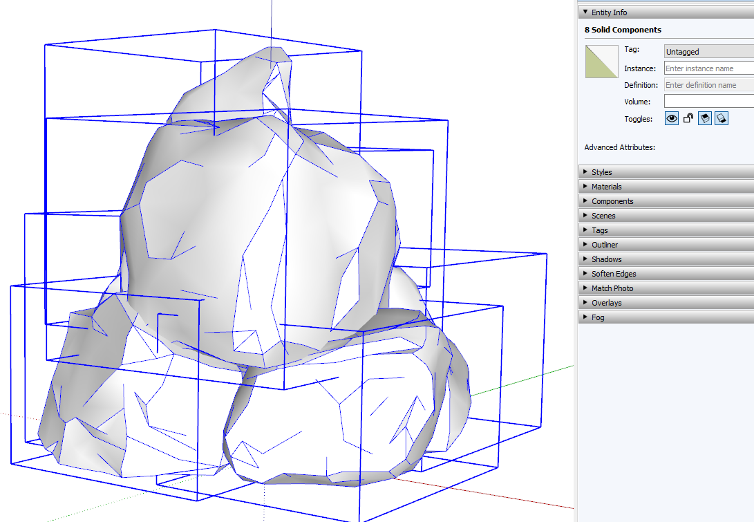

Here’s a quick example. I took the first “rock” model that turned up in the Warehouse. One of them had to be fixed to make it a solid. Then I moved them together to make it look like one large rock. You can see that they are still eight solid components, though.
I modeled a simple, slightly oversized M8 bolt (only because I knew the size of the head off the top of my head) to use to create a space for ballast. An M8 x 20 stainless steel bolt could be glued into the bottom that way.
