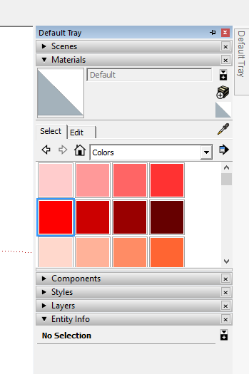

Here is screen shot of the Materials window, you can see the color is selected, but the big material square does not change… If you click on Edit - everything is locked.
It really sounds to me like a Material folder Permission problem. - can you tell me how to check if that is the problem?
Very basic: I presume that you know that clicking on the colour in he materials docker fills the paint can tool with that colour - to apply it you then have to click on the relevant faces.
If you have multiple faces selected before using the paint tool, then clicking on one of these will fill all the selected.
(I am only mentioning this because from the above text it sounds like the user is wanting to select the faces, then select the color they want the faces to be - expecting the selection to change when the pallet is clicked.)
Actually, I have bigger problem… I can not select colors at all, unless they are in model colors.
Hi i read all the answers the problem remains… anyone found the solution?
You can’t edit materials on disk: those are write protected so you don’t lose original materials by accidentally overwriting them. In order to edit a material, you must first use it somewhere on the model. This places a copy of the material in the model’s In-Model collection. The material can be edited in the In-Model collection, only affecting instances of the material in the model, The material on disk remains unchanged.
