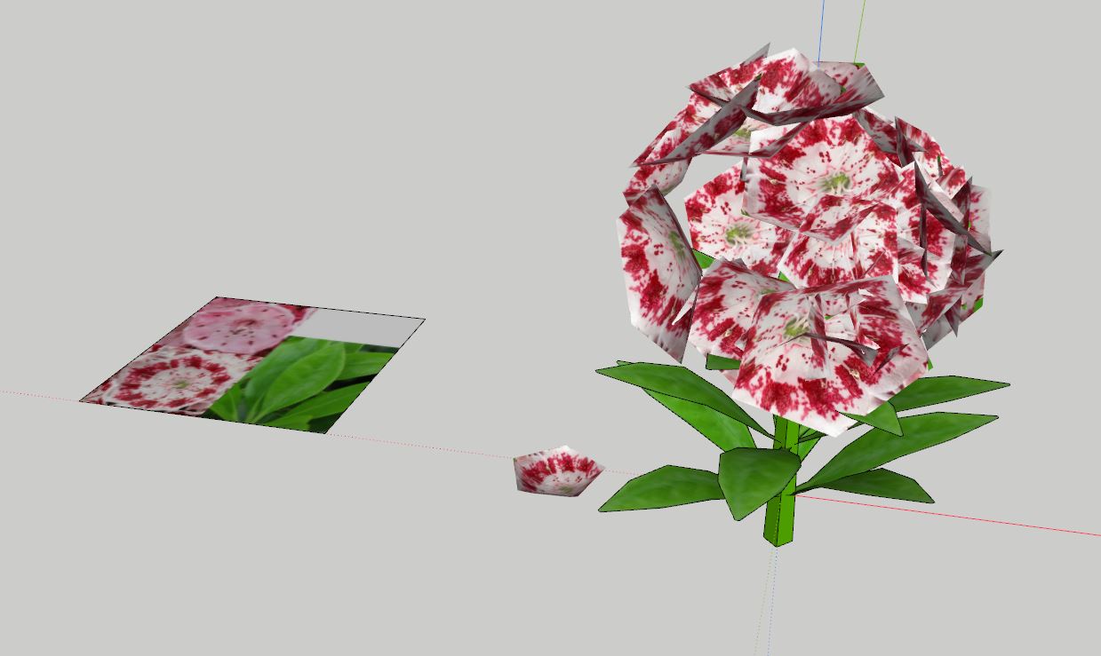

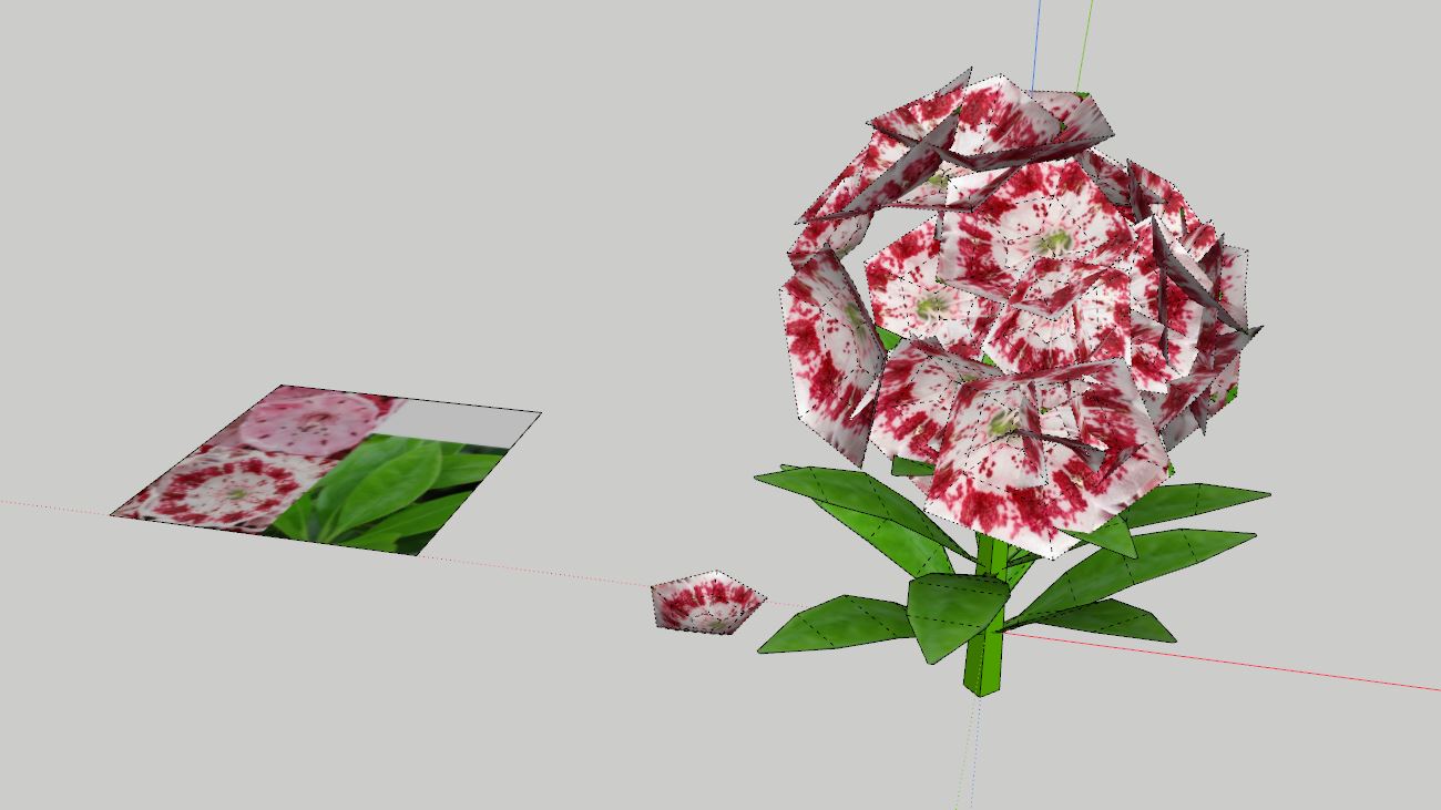

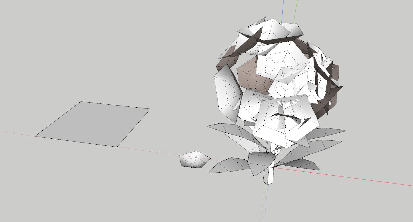

Combined plant:
Oh this is interesting, thank you! I often can squeak by with models that approximate the plant I need (tall, spiky foxglove substituted for tall, spiky black cohosh, for example) but my clients usually want to see detailed depictions of the true plants.

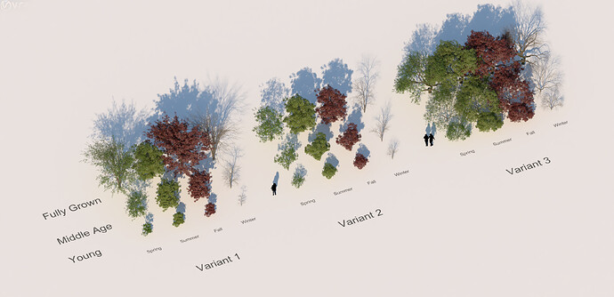

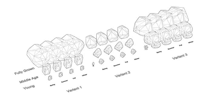

I personally like using Laubwerk - which comes with a plugin to help choose and select plant variety. For example, each Laubwerk plant comes with 3 varieties, 3 ages, and 4 seasons - which gives you 36 plant options per species. With 10 per bundle (comes at a cost of course) you get 360 plants available to you.
