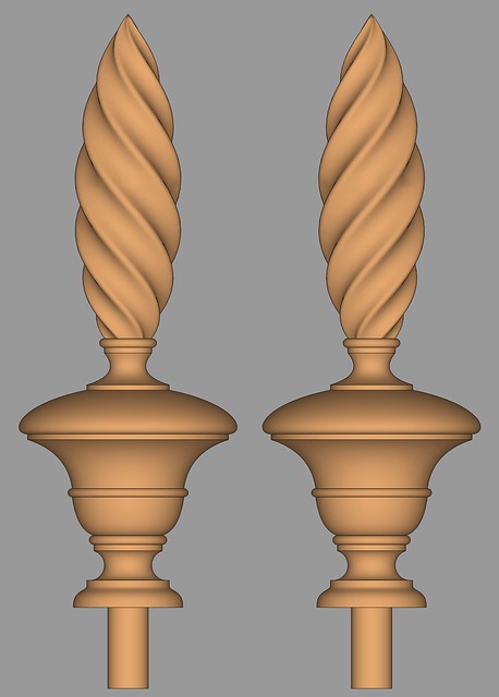

Example: The model for this flame finial is solid and could be 3D printed if desired. No Boolean tools were used anywhere in the process.

I suppose practice.The flame finial was done for a tutorial I wrote. It was done without using anything special like the Solid Tools so that those who are using SketchUp Make could draw it, too.
Just eyeballing it from your image. The only non-native tool used was Classic Bezier from the BZ_Spline set. No Solid Tools or other Boolean tools.

Yes. I didn’t use either one.
Since I was working from your screen shot and just guessing at shapes, I’m sure mine doesn’t match yours exactly. I could have drawn it without the flat corners just as easily.

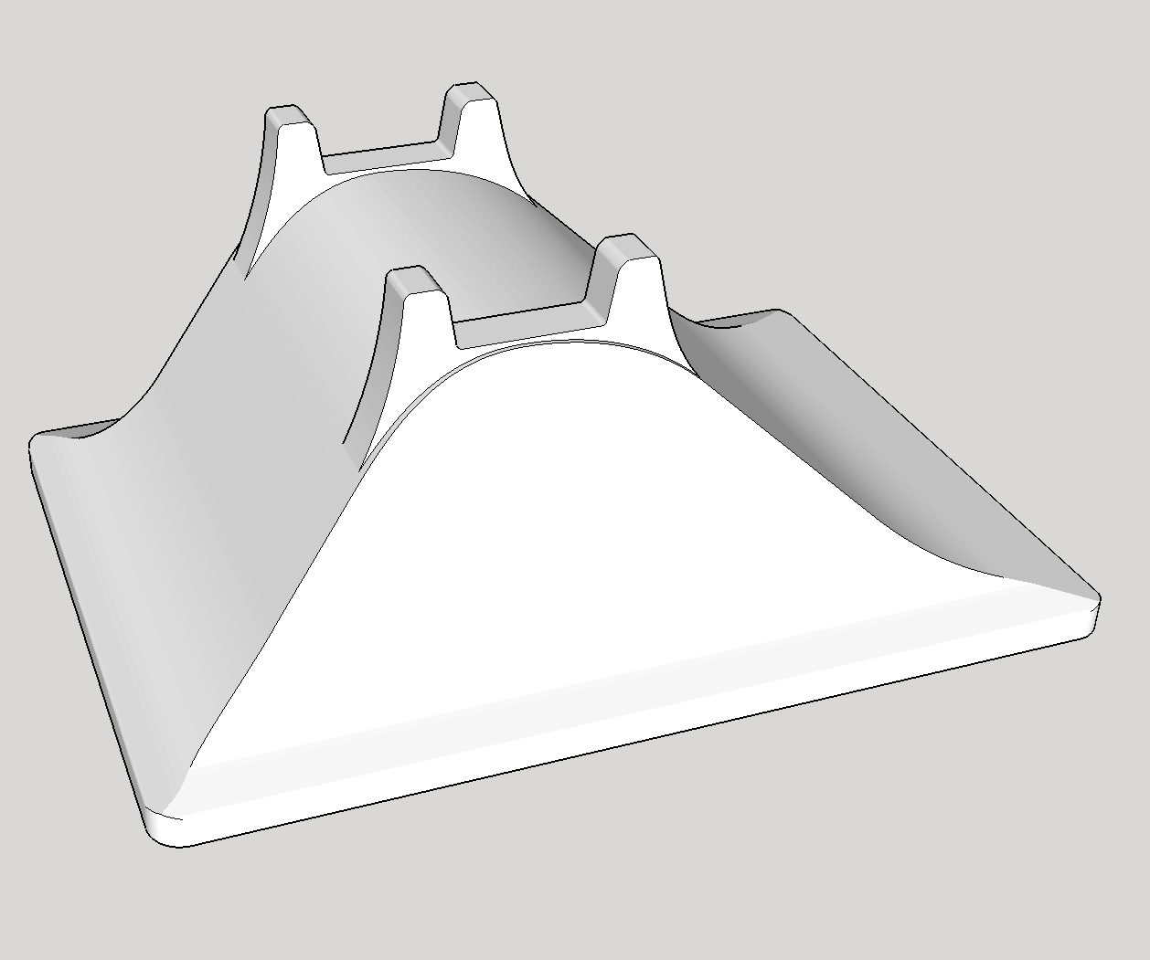

I had no idea you’d cooked up that example after receiving my screen cap. It took me days to get the phone’s “shell” half-right… I thought you’d dug up that example from somewhere.

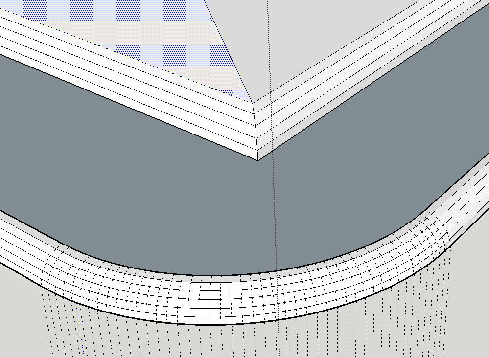

At any rate, like I said earlier, I’m still not quite happy with the solution I settled for, as regards the base of the shell.
I’d like for the top-tier corner to match the bottom one,
but the rounding-off entails “eating” into the slope, which I’d like to avoid:
How would you go about making a neat corner and keep all the relevant geometry?
I did just “cook it up” from your screen shot. If you’d looked at the times right when I posted it, there was less than a 1/2 hour after yours so I really didn’t have time to do a whole lot of sleuthing to get accurate dimensions. As I said, it was all by eyeball.

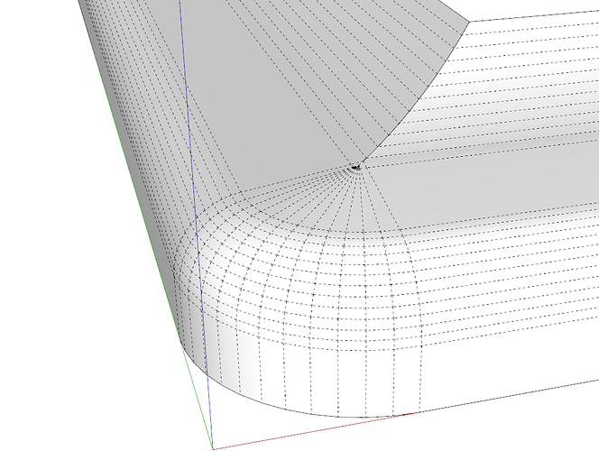

Is this more like what you’re after? I just used Follow Me and an appropriate path with a radius for the corner. And again, no Solid Tools. I only used native tools that are included in Make.
I dont think so; The tip of the combined beziers should go right to the center of the topmost corner radius. Hard to tell here, but from the shadow play it looks like there’s no slope to the wider rectangles in the shot. These should be just off the horizontal plane, so that there’s a ridge where they meet.
Said ridge should start right where the rounded-off bevel finishes, as in this really accurate model:
Just change the profile to suit.
