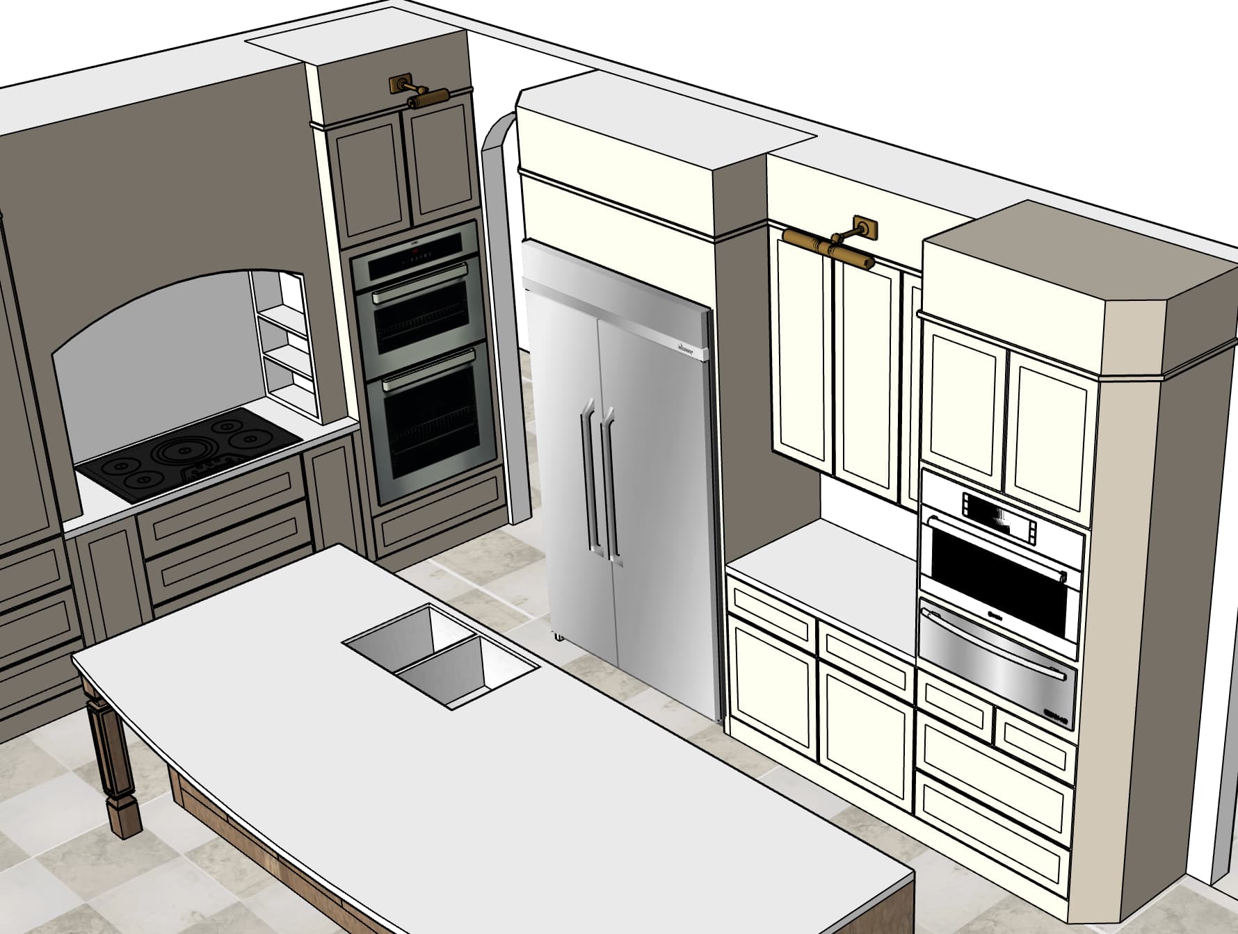

Good day. I need help figuring out why colors on my model are showing up completely different. I know they are always a little different, but I have never had them this so far off.
Looks like you have Use Sun for Shding turned on in the Shadows panel. Turn it off or adjust the Light and Dark sliders so they are closer together.
What operating system and what graphics card? Your profile says iOS but SketchUp Pro doesn’t run on iOS. 36gb does not identify a graphics card.
sure did! Thanks Dave. I’ve never used that in my life.
If you want colours on screen to match the swatches in Material Browser with no shading, turn on “use sub for shading”, set the light slider to 0 and dark slider to 80 in the Shadows tray.
