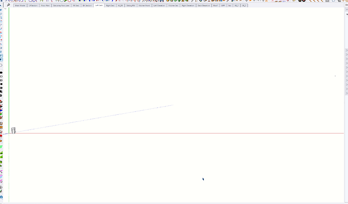

First, there’s a component at a huge distance from the rest of the model. Go to the Top view and hit Zoom Extents. You should see something like this. Way over on the right side there’s a tiny black dot. That’s it.
After deleting it and hitting Zoom Extents the camera zooms in on your model as expected.

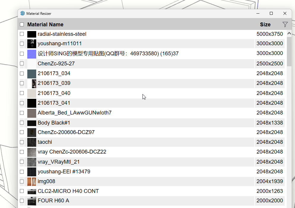

Then I looked at the sizes of the remaining materials. A number of excessively large ones in your model. There’s no benefit to have huge texture files.
This clean up reduced the file size by 64%.

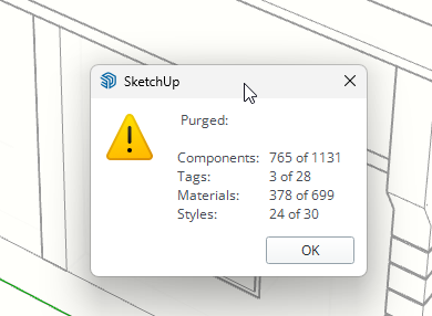

Second, I used Purge All from Sketchucation to purge unused content from the model. You could also use Model Info>Statistics>Purge Unused but I use the extension because it gives that nice little report.
Third, I used Material Resizer from the Extension Warehouse to reduce the texture sizes.
