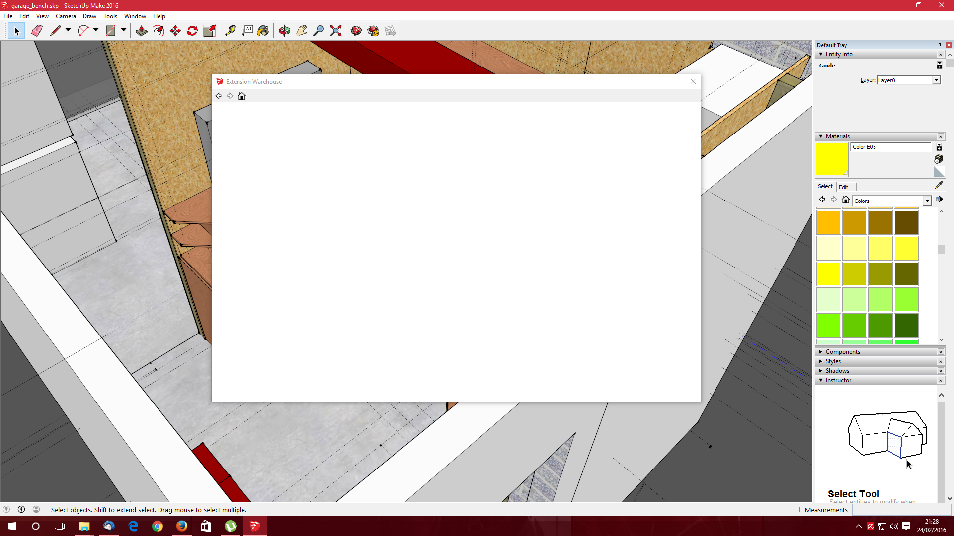

Does it normally just sit there with a white box after clicking download? It’s been like that for about 15 minutes now.
It’s still the same. Do I get something that works if I pay for it?
So how do I download this Dynamic Components if I get a blank box (over 40 minutes waiting), the website for extensions.sketchup.com reports “Notice: unserialize(): Error at offset 35 of 41 bytes in variable_initialize() (line 936 of /mnt/www/html/sketchupewh/docroot/includes/bootstrap.inc).” error and goes to the same white box.
This seems like a crazy way of getting you to buy it!
Ah wait, it came on. I hope I don’t need to use this too often. 50 minutes to install a plugin is silly!
That is not normal behavior.
Try going to https://extensions.sketchup.com/ in your standard browser. If you can get there that way, it is likely that your Internet Explorer is out of date.
I was using FireFox and directly through the Sketchup application. I’m still seeing the page error every so often but at least I’m not being stopped at a blank screen.

If you are opening Extension Warehouse through SketchUp, you are using Internet Explorer (SketchUp always uses IE or Safari, regardless of your default browser). Try it in just firefox, manually, it should run well.
Oh wow - didn’t know that. Thanks for the heads up, I’ll bare that in mind in future. Strange that they don’t opt for Edge since its the new Windows 10 fad and has improved security.
