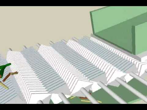

Here’s a link to a video showing a model I am particularly proud of
Thanks DanYHKim
Interesting video/sketchup. Looks like a lot of work has gone into it and it works well.
