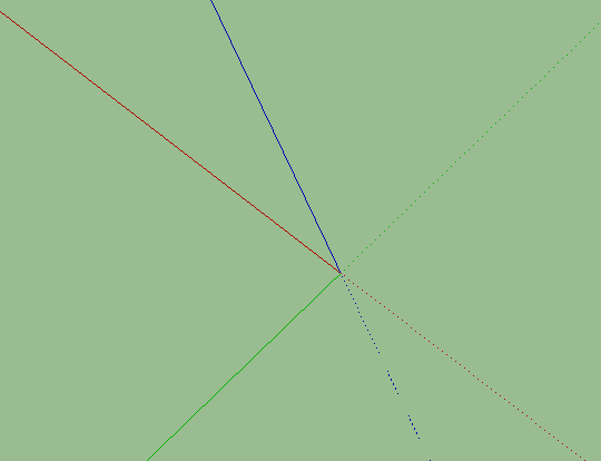

I am VERY new to sketch up. I have just started at a company and was asked to learn it. I have watched every YouTube video I could find. That has answered all but two questions so far. They are very basic, you would think I would have figured them out by now.
When I create/add a from the 3D warehouse the lines look/print very burry, Is there a way to make them to look more crisp?
Also like to know how to change the color of the lines from black to white? I have tried selecting the line and using the paint bucket.
Well, still does not make much sense. We would need an example, model name or model id number from the 3D Warehouse, in order to see if that was the issue.
But, I think it is just styles again. You likely have some “Sketchy” style chosen. Open the Styles inspector window and choose another style that is less “Sketchy”. Tweak the style by switching off Profiles, or Endpoints, and especially Jitter.
