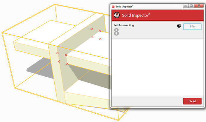

Solid Inspector 2.2 which is released soon corrects a good number of bugs. in 2.0.
Though, it doesn’t catch that your spoilers have some self-intersecting geometry where you need to intersect the faces before a shell for 3d printing can be resolved.
Thomthom is correct as expected. The models report solid when the entity info is queried but there are some groups that must be intersected plus when you do that intersect and you clean up make sure the internal bits and pieces are cleaned up also. If you use model info and set the rendering to hide rest of model when you do that will make your job easier. If you what to make the spoiler as a snap in then you need to include post & hole or some approach to allow that to happen. You need to allow about 6 thou clearance so enough interference but grab to allow hold. You can find that by search on the net but will depend on print material you use.
