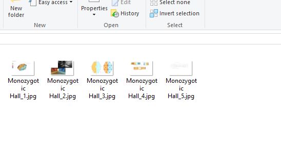

Then maybe “export images” will work as it outputs individual sequentially named files. in either png or jpg at a specified resolution.? I’m windows assume function is on mac too?
